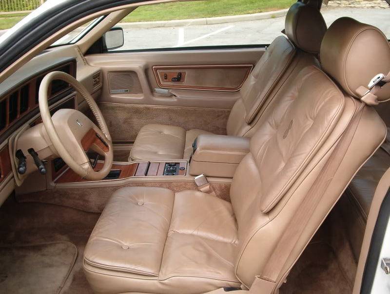

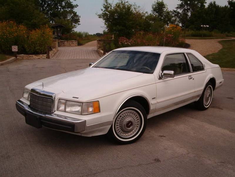

I'm really in love with my Mark VIII, so I'll likely be selling this car. But - as requested, here's a few pics.
