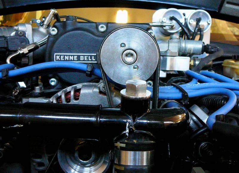

Now that you've got it off, I'd swap it out for a stainless plug with a hex on top. It'll make it a no-hassle deal down the road.
I need what is attempting to hide behind the plug in that picture...

Most of these I have seen have a nut welded on them, I didn't recognize the plug in an aviator because it had a nut welded on, and smoothed.
