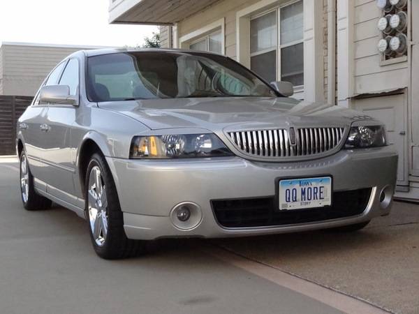

On the upside, she is purrdy. It's like with women - we see a nice face/body, and try our darndest to put up with her personality :p
