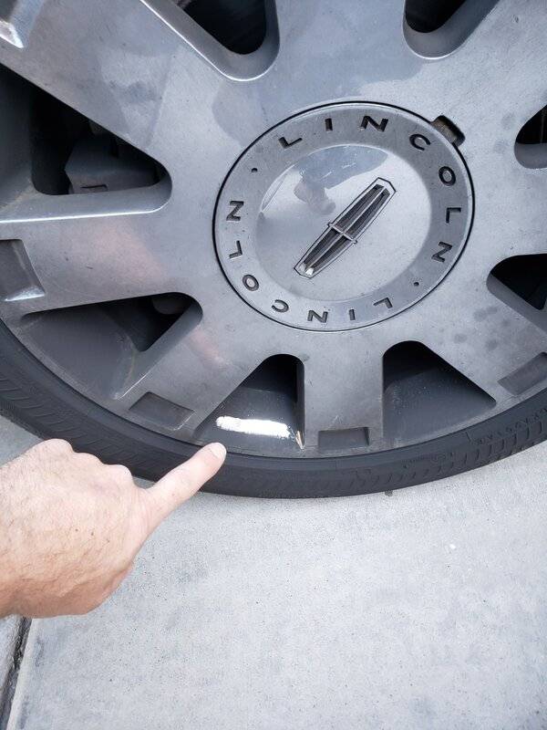

Brakes are undersized for as fast as the car can go, that's just a fact. They get hot as shit real quick. might be all right for one stop from 100 but go try it three or four times in a row and then tell me what you think. I've got drilled and slotted rotors and carbon fiber pads to install this weekend that will hopefully be an improvement. Stock is fine if you drive like grandpa maybe but if you drive it like a sports car they're gonna get HOT. I definitely drive more aggressive than most, can't wait for the upgrade cause stock brakes suck.!
Bullshit ! I've done it repeatedly on a couple different occaisions. $10 Autozone brake pads and rotors won't do it... but factory Ford rotors and Akebono brake pads will.
Well I'll give ya an update after I get the power stops on. I expect a definite improvement.
