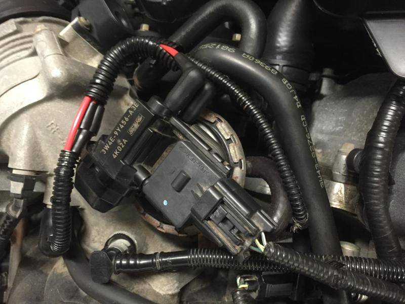

There have been a few EGR assembly failures reported on here, including one of LSes.
Get Motorcraft, not aftermarket. Those who have tried aftermarket and reported it on here, reported that aftermarket didn't work for this part.

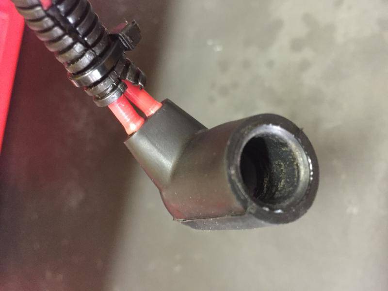

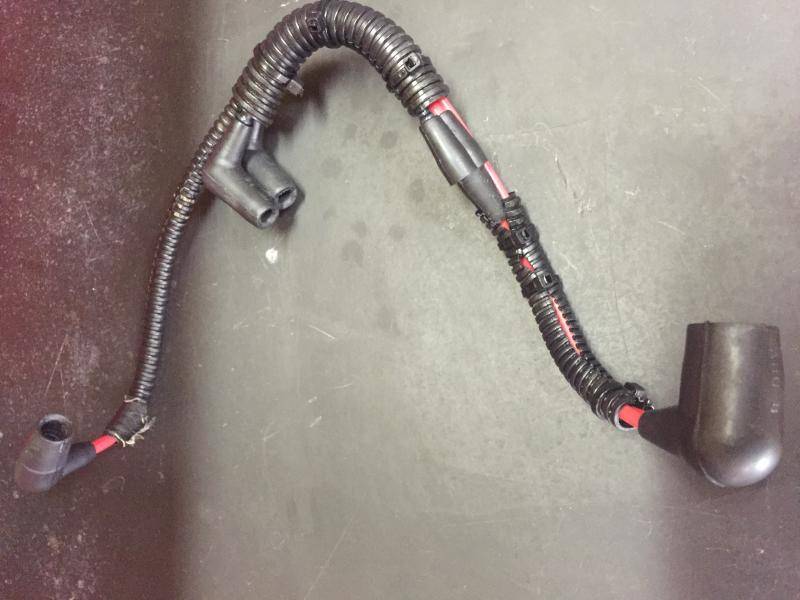

Be aware, I just had my mech do a refresh on this system when he was doing the timing chain tensionor. He got in there and found a previous mech had done a hack job on my egr system. Makes sense since it failed smog 3 years back. Anyhow, he replaced all the hoses we could find since most of these are discontinued by ford. We found 3 (all with corrugated tubing) available at leftover parts places - that piece was not one of them. He showed me that not sure if it was bad, but I assume he put it back in. If you find one of these can you post the info - I might grab it as a spare since its so complex.
Edit: Doh
Never mind, I just noticed the OP was a v6. I am v8. Maybe a lead can be gotten still, but I imagine you will see same issues on availability on the v6 as well.
I think that you are mixing up the PCV system with the EGR system. There are no corrugated hoses/tubes associated with the EGR.
I am sure I am. From what I saw it was all hacked up with electrical tape holding things together! I do remember him showing me a piece like that though..... :)
Replaced the EGR with Motorcraft - took care of it - thanks for your insight
