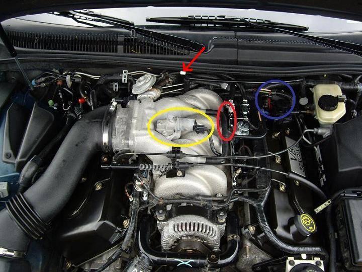

Good info LASERSVT but the problem is I need some pics of these things I have to clean... lol.. What large vacum hose? Where is the IAC located? Would putting seaform in the fuel tank make a difference or no? Also, after putting seafoam, after how long should I notice a difference?

Pour just over half the bottle in a half tank of gas then take the rest and pour it in the intake. In the following picture you can either disconnect the red line and pour it in there or disconnect at the blue circle and stick it in the bottle to let the car suck it in while having someone hold the car at 2000 rpm.

The IAC is the yellow circle. Remove it and place it upside down on a bench and fill it up with a throttle body cleaner and let sit for a half hour or so then dump it out and spray the leftovers out. Make sure to get a new IAC gasket first though cause chances are the one you have is dry rotted.
i will do that tomorrow, seems like pouring in the red circle is easier, should the car be running for the red circle or no? Also, after how long should I feel a difference. Also, my buddy who works at the dealer was told about some black box by the firewall with some wires possibly disconnected and is a common issue, familiar?

Yes the car should be running while it sucks up the seafoam through it. Basically the idea is for the seafoam to remove the carbon that might be causing the IMRC to stick and not close or open. I would do two treatments of seafoam before you have to check the other stuff.
