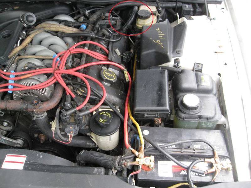

My car now starts at lower RPMs but still wants to stall at first. I still have the code and poor gas mileage. I have read that seafoam through the brake booster is the most effective way. I would like to try to pour seafoam through the brake booster vaccum line. I have no idea where the brake booster vaccum line is or how to unplug it. I have heard that it is in the back of the engine.
Can anyone show me where the brake booster vaccum line is and some tips of how to do this? Any other suggestions? If nothing else Im going to pull an IMRC from the junkyard.
