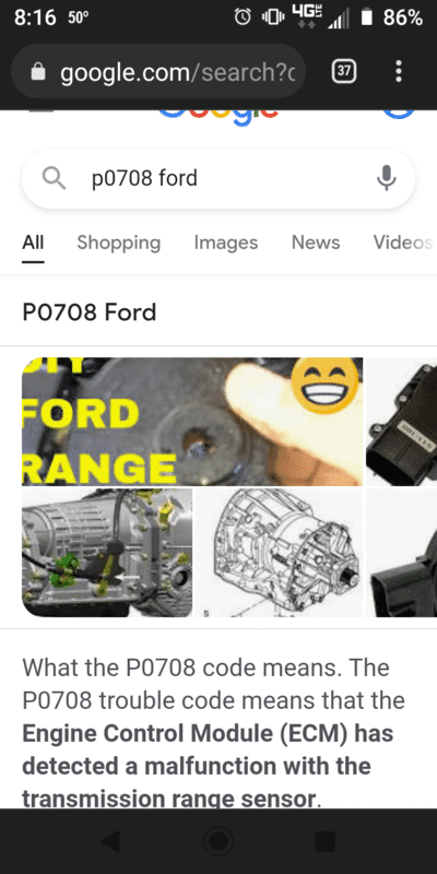

You didn't look very hard.
Thank you for the response and I did Google it before I asked LVC there advise. I was trusting LVC members instead of Google since LVC members have more knowledge and tips from hands on experience with problems. Anyway , thanks for your responses and remember today is Veterans Day and all of us would not have the Freedom we all have if it wasn't for someone else. Have a good day and God Bless
For sure, you can pretty much find multiple answers to any question on Google cause lots of dumb people that don't really know try to answer them. I read about 5 and usually you can figure out who knows and and who doesn't, ha
