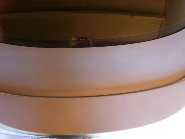

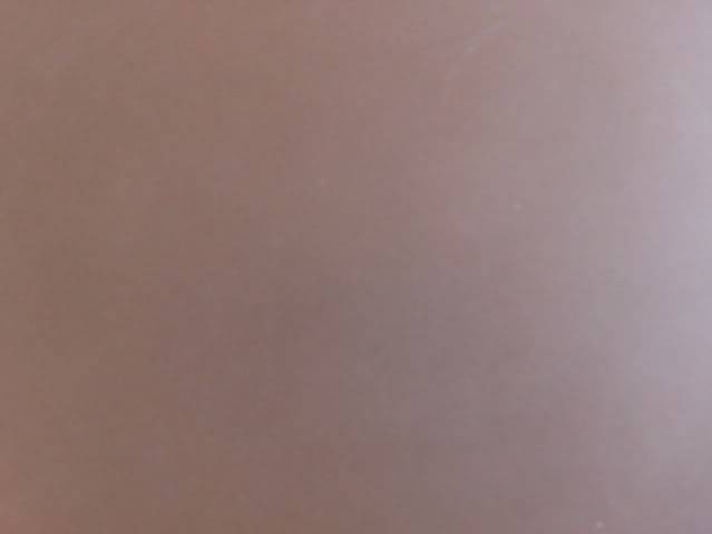

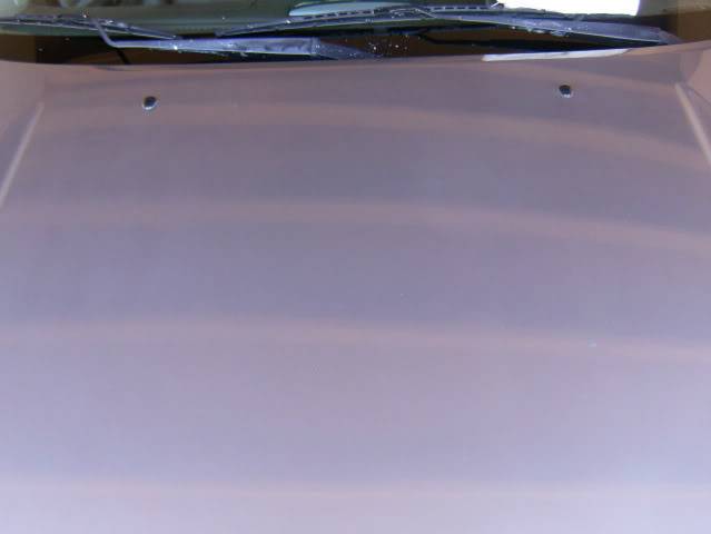

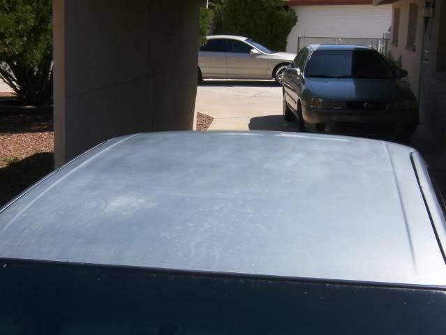

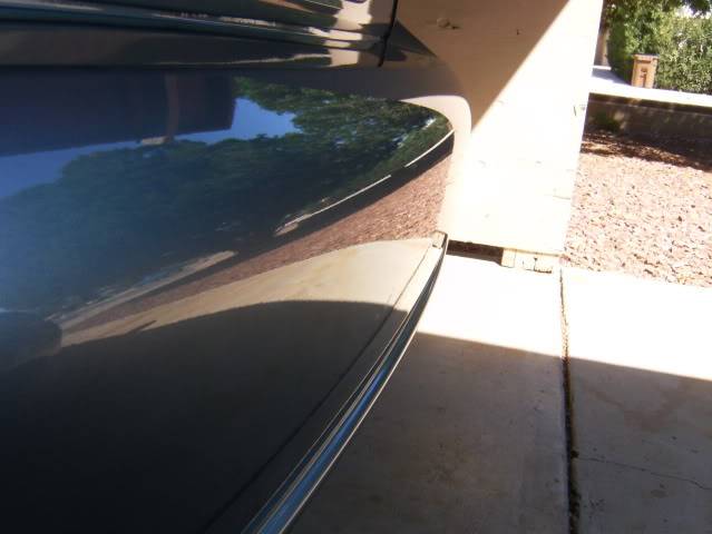

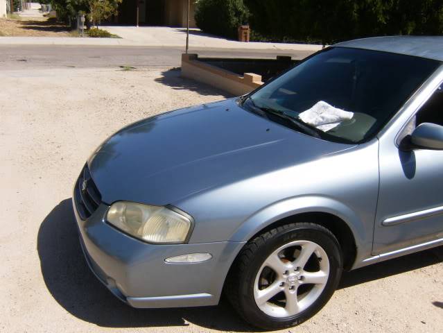

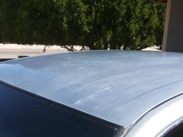

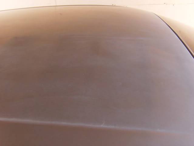

:mad: i used a buffer. nothing high speed or da. just a 10" orbital buffer. next is gonna be a high speed. here are before and after pics.
before
after
and a few randoms
the shiny pics are compound only. no no.26 the nasty ones are after the no.26 those pics are the same as before i did anything to it

Alright I see...
Well I'm guessing you were using a cloth bonnet on the buffer... this stuff is junk, but it's what you have.
I think your compounds are just too weak for what you are dealing with, even if you had a high speed rotary.
Look up Meguiars M105... its a very aggressive compound with micro abrasives that don't break down.
