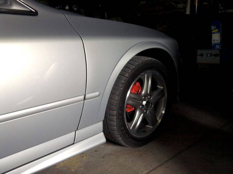

I just painted my calipers red & black.
Initial cleaning was with 3 different sized hard wire brushes, and 3 different sized brass brushes.
Then used caliper cleaner spray, and cleaned again with the hard & brass brushes.
Then cleaned again with caliper cleaner and brass brushes.
Masked off everything thas was supposed to be red, and everything that is not supposed to be black.
Painted 4 coats of Rustoleum Engine Enamel Gloss Black Spray, and then brushed on 5 coats of Duplicolor Red Caliper Paint.

Huh, I just hit mine with some brake cleaner, let it dry for a minute, then spray them with rattle can paint. I have done that on several cars, and they all have lasted tens of thousands of miles; plus, I can just hit it with paint again if it needs it.

I did mine with caliper cleaner and rattle can caliper paint. You did a lot of work lol but it does look good.

Thanks everybody. Yes the calipers were painted while on the car. Just metal brushes for cleaning, caliper cleaner, masking and then paint.
I did a quick scuff of the bracket and caliper on mine and used brake cleaner to clean them. 3 coats of blk duplicolor caliper paint and she's been fine w/o chipping since..Stuff is pretty good.

The original plan was a rustoleum high heat satin black (handed to me by the HD employee), and duplicolor caliper red. I started spraying black but out came a flat dark grey brownish color. So I put a 2nd coat on to see if it got blacker, but it was a dirty dull grey/brown. I had to go to the nearest Autozone and all they had was rustoleum engine enamal gloss black. So I put on two coats of that black over the other two. Read the original can near the bar code and it said BBQ Black. The 3rd coat of brushed on red started to look good, 4th was perfect, and the 5th coat just because. It's better than when I started, with rusty outer edges of the rotor and dirty/rusty unpainted calipers.
