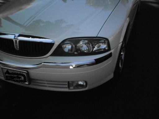

night shades...
I did mine with night shades tint. it's a spray and you can do serveral layers or less depending on how dark you want it.
I would strongly suggest wet sanding your lenses though. It removes all the factory lettering from the lense and creates a smooth clean look. See
02V8sports lense it will remove all of the factory lettering. I'm not saying his doesn't look good, but if you wet sand it, it will look smoother.

Thats a good suggestion, I didnt know this when I did mine and didnt like the lettering showing through. Definitely sand them first.
It's real easy, Just use water and a fine grit sand paper, alittle elbow grease, and they become very smooth. I am glad you didn't take offense to my comment 02V8sport.

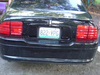

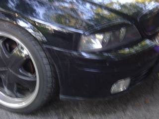

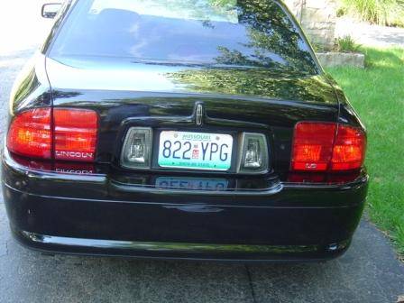

also go to autozone and but some clear coat spray so it doesnt fade or come right off. i did like 10 coats on mine till the were dark as night then with the left over i did an extra set of reverse lenses that i had laying around. heres the pics what do u guys think. the b4 and after and then the side markers. when i bought the ls the bulbs were already blown so i never knew they lite up so i kept them that way.
