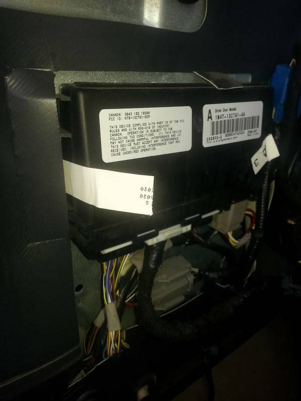

I haven't tried this to see if it's true, but this is what another LS owner reported.
"I found the keyless entry code on the driver door module there is a sticker with a barcode above the bar code is a number that will look like this
xxxx-xxxxxx-xx
you can see it by simple pulling out you power window switches the middle 6 digits will have a letter in it take the letter out and the other 5 digits will be the lock code for your car."
mine had the sticker
Well, I guess that guy was full of it. That's just the factory part number for the module.
i haven't tried this to see if it's true, but this is what another ls owner reported.
"i found the keyless entry code on the driver door module there is a sticker with a barcode above the bar code is a number that will look like this
xxxx-xxxxxx-xx
