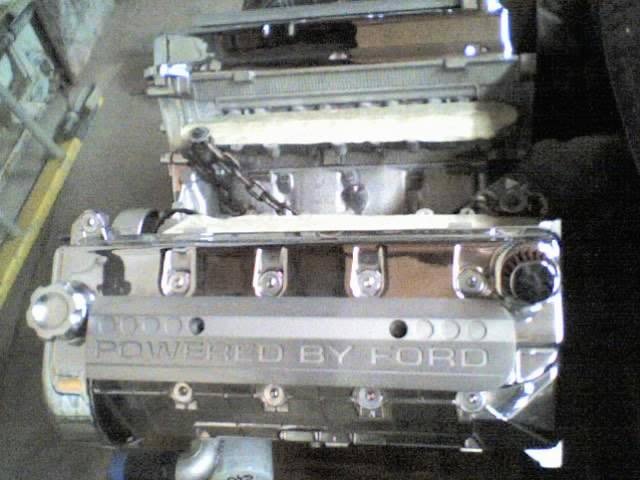

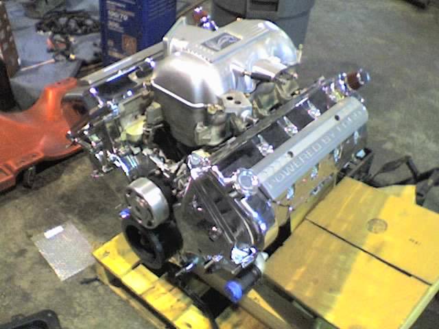

That is real chromed OEM parts, like powder coated OEM parts, it looks good. I bet the chrome plating on your engine cost you more than a lot of people's Marks here did though.
I had the chrome cam and timing chain covers done about 4 years ago, it cost around $1,400 from what I remember. That prep quality is not perfection, but they still look great and the chrome job appears to be durable. That is what actually let me to build the stroker. When I pulled the old covers for the swap, I found tons of sludge, I have pics somewhere, I'll have to post them. Very gross, I couln't bear to reassemble the engine like that. I had purchased the car in '01 with 50k on it and always used Mobil1.
Now I have a better idea about what chrome pieces you don't like.
