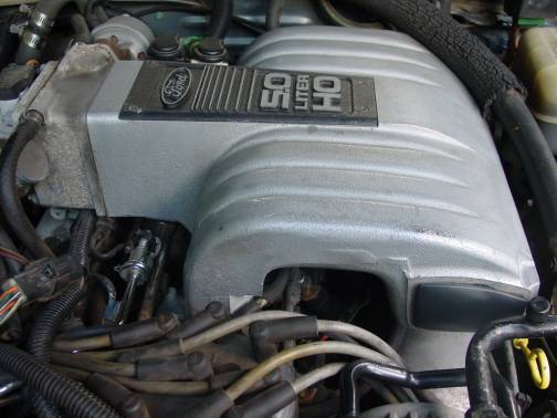

Bone stock eh?Black87LSC said:I'M GOING TO QUESTION YOU. I have a totally untouched, bone-stock motor 87 LSC and its got the H.O. in it. If YOU have a question about it, ask OldSchool and i'm he'll tell you every detail of the H.O. bmnlsc's got it right!

Um. It's cool. See aboveyamaharollinhard said:Now you also just went back on you own word with those pictures, and just because the engine has a HO on the plate, doesn’t mean that it’s the HO. If it says EFI anywhere on the plate, its more than likely not a HO, even if it says so. Those plats are universal on all factory 5.0 EFI motors, and means noting. The only way to know 100% that it is a HO is to take the heads, cam, and compression ratio. The heads will have a E7 stamped on them and the cam you just need to measure. Not hard, just time consuming. The HO has forged pistons so that would be a dead giveaway. Unless you your self bought the car form the dealer and worked on it yourself, you don’t know if the motor has ever been touched. The standard EFI motor has never been dynode at anything more than 180 at the flywheel, I had one and dynode it, CRAP.

Look at the 8th character in your VIN:my1stmarkVII said:I dont know anything about it really, my car is an 86 mark VII lsc, and on the motor it says 5.0 litre HO, is it what it says it is?

This is a grey area that I only partially understand. I understand this from a Lincoln Mark VII aspect and not from a Ford aspect. The Mark VII only had a V8 gasoline and an inline 6 diesel (1984-1985). The 3.8 is foreign to me except for our 1992 Sable wagon and 1986 Mustang. Again, I'm clueless outside of Lincoln Mark VII nomenclature.yamaharollinhard said:Now when you go around telling people that the 8th digit, you need to be careful, the vin changes after 88. in 88 E=HO, 4=3.8, and F=5.0, but before that, you are right, and 90 was the last year of the 5.0 efi.
Dude :Bang !yamaharollinhard said:Now my 88BB has the letter E and it is a 5.0HO, and a dead giveaway before you go ripping your motor apart would be the factory headers. The 5.0eft had manifolds.
