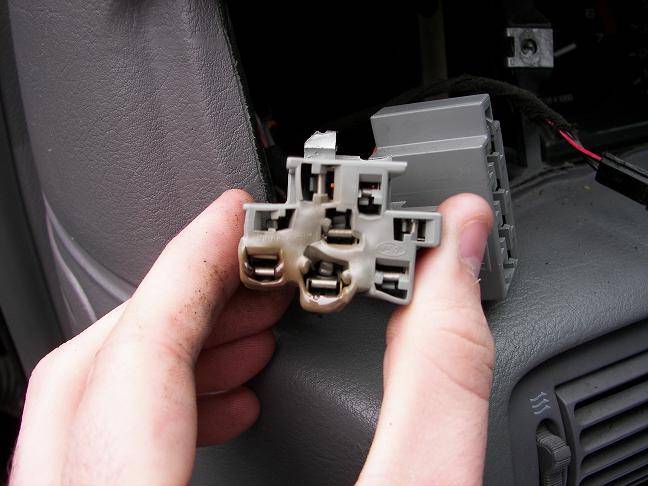

Yeah, I replaced the switch and haven't had a problem since, I broke the bulb that sits behind the headlight switch but thats not important, look at the connection to the back of the switch...
WOW that sucker is toast ,good that you got to it before it got worse and shorted out the whole system
