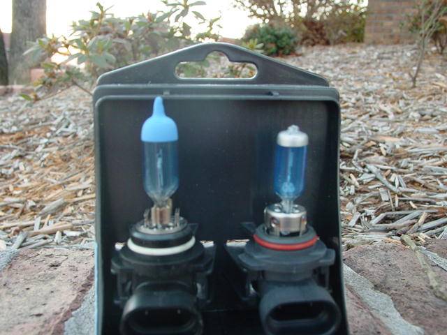

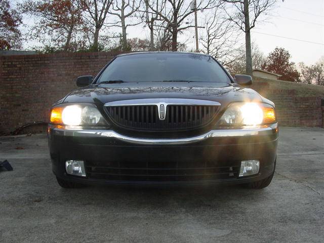

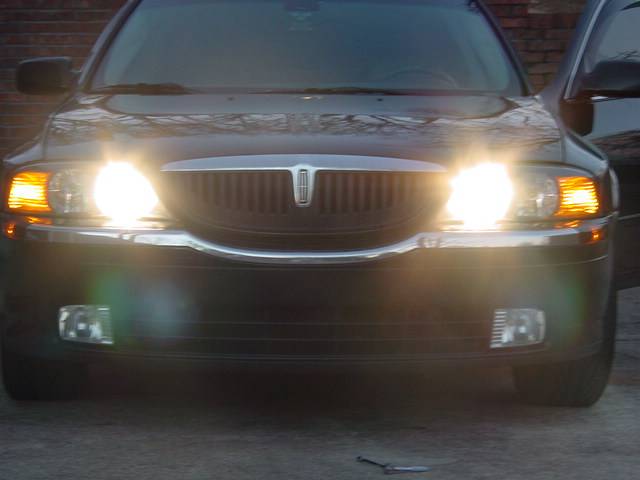

The PIAA is on the left and Hoen plus bulb on right 9006

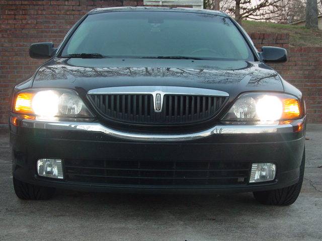

Now the HOEN plus is on the passenger side and the PIAA is on the left.
Both HOENS installed but no harness upgrade

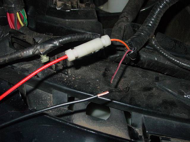

Wiring the harness
Posilocks rock!

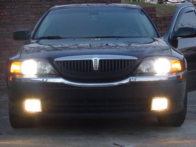

New harness' with fogs
Note: the HOENS fit better in the housing than the PIAAS.
how did u keep you high beams on with out u holding them, ive been wanting to do that. about the comparison. its hard to tell without being there to see them
You push the blinker knob towards the dash and the high beams stay ON.

The harness' are very easy to install I just clipped the end off and matched up how the harness' locked into the bulb and reconnected them with posilocks
The "look" of the beam is to me closer to HID than the PIAA, the lenght of the throw is as good as the piaa (didnt expect that) it apears to be long and fairly wide. I thought PIAA's were the best out there when I bought them...but they would not for some reason comepletly lock into the housing and since they lasted less than 2 years and they wouldnt fit my mind has been changed to start using HOEN I will be changing the rest of my bulbs to HOEN. BTW I also had PIAA 9005's in my fogs and they blew in only a few months and I know how to handle bulbs I also had PIAA on my 95 mustang
OK, so the PIAA's don't fit easy and the HOEN's are equal to or better than what I'm used to from PIAA. Plus they have more of an HID look. I'll be going with HOEN's as well. Thanks for going to the trouble, gt95coupe! :xmas:
