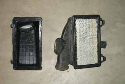

here's few pictures.
first my beloved LSE.
as I have mentioned before, dropped 1-in all around with eibach, CAI, eyebrow, red emblem. soon to come, exhause, angel eye... saving up money to pay off the car.

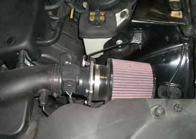

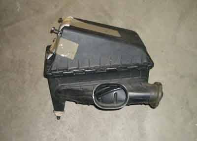

here's few pictures of what I did for CAI.
took the stock airbox, used the top portion for air scoop routing it to the front. as you can see, I think this will bring more air to the KKM filter instead of having just 3-in tube there.
let me know what you all think.

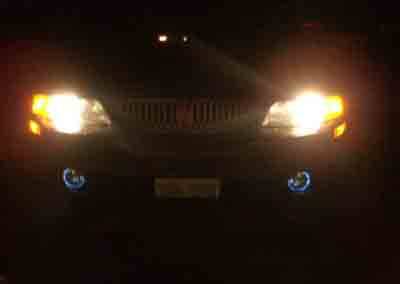

and angel eye on the foglight.
again, let me know. I got pulled over for having them.
SPD said it was too blue. just a warning.

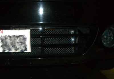

I also chopped off the license plate just enough and repositioned it to bottom grill. give me comments/other ideas...

FYI - When I initially set by CAI up - I ran a similar setup from the lower grill. I found that to pushed too much water up into the engine area, and the filter would actually get wet, engine would get wet - more so on highway driving.
I then built a box around the filter and drove the hove up form the bottom, adding a slight baffle in front of the airstream. the box kept the engine bay clean, the baffle kept the filter dry. then you got to poke a hole in a low corner to drain the water that get in.
wow that was a great reuse of the airbox cap. The eyes look good on the fogs if you do the headlights I would probably sitck with doing one set so you dont over kill. I think doing both the fogs and one set on the headlights would look sharp but you need to color match them.
I would box in the area where the air box used to be with black or mirror plexi. It is easy to cut and easy to bond. cut a hole for the hose and you will have a nicely finished job.
yeah, I have little worries about water travelling up and getting the filter wet.
especially since I live in seattle. I'll drill a hole for water outlet.
I agree that angel eye on both high and low along with fog will be too much.
I think first, I NEED to find color matching angel eye.
or if I get grayghost's angel eye I'll take off the angel on foglight.

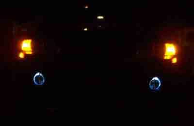

The angel on the fog lights are they onside our outside the lense? I have had the fog lights out and am curious if tehy can be seperated.
the angel on foglight is on the outside.
The rings are pretty much just glued to the foglight. I used a silicone.
I think I would get more life out of them since they are outside and not taking in the heat from the foglights.

I would love to take it out but it's illegal here in WA.
I have plenty of friends who got pulled over and got ticket for not having it in the front. so I did the next best thing which is to move it down instead of it's usally spot, right in the middle of the bumper.
I guess I could have it on my dash (which is what most people do here) but I dont want to clutter the dash with a plate.

did you use the relocation kit. It was mentioned in another threaed and a member there has to put a tag on. If you can post here how oyu did it.
http://www.lincolnvscadillac.com/showthread.php?t=6216
I couldnt find a suitable mounting kit.
and too lazy to fabricate using the stock plate holder.
(you know me, Im all about using the stock components for better use. :invasion: )
so I just used a zip-tie to hold it in place.
luckily, WA dont need a sticker tab in the front so I was able to trim the plate to just show the lic plate number and have minimal space blacking the lower grill.

Check the phone book or internet for some plastics folks. My grandfather used to buy stuff other there in OTown all the time at a sign shop. You can buy the scrap by the pound rather cheap. Acetone is a great bonding solvent. I will ask my grandmother is she can remember where the shop was at. I want to say it is on JYP but not certain. They live over by sea world in willamsburg so I know it would have been rather close to their home. He passed away last november so I can't go straight to the source now.
Hey glad to see you are in the SE chapter. The Tampa/Orlando membership is growing pretty stong now. Do you have the V6 or v8? I might have asked in another thread but i forget where it was.
looks good bu that is not a CIA. A CIA would be completely sealed like THIS or even your stock setup is actually cold air. What you have there is just the filter in the engine compartment soaking up hot air, not feeding in cold air at all. I just wanted to make this correction because I see so many people saying CIA when it isn't.
ONEBADMK8 said:
looks good bu that is not a CIA. A CIA would be completely sealed like or even your stock setup is actually cold air. What you have there is just the filter in the engine compartment soaking up hot air, not feeding in cold air at all. I just wanted to make this correction because I see so many people saying CIA when it isn't.
I would prefer to call the set up Ram Air Intake since its not cold air.
