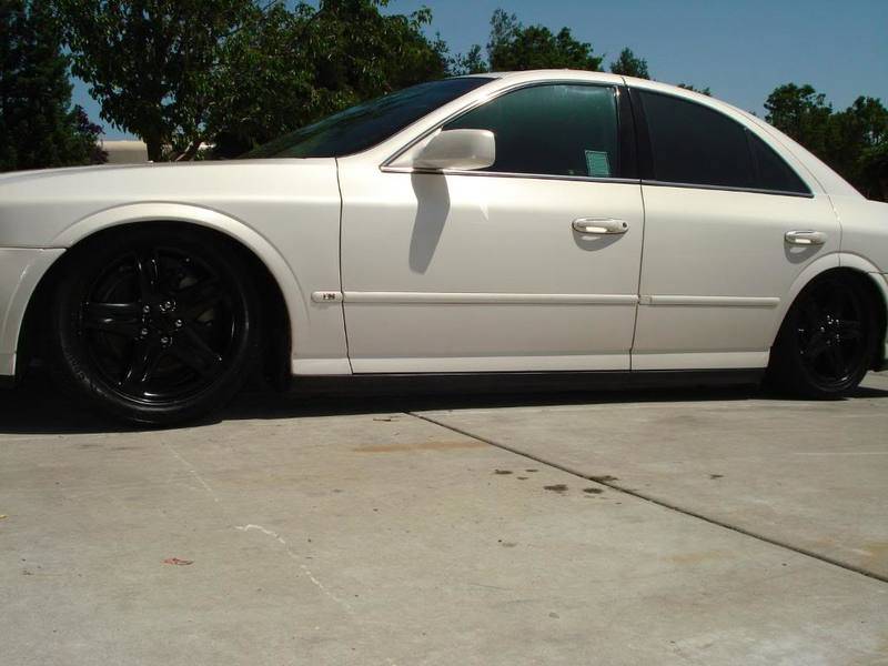

used stock rear struts in the front and cut out the inner fender wells and moved the wiring harness that crosses the wheel wells up...in the back i used stock rear struts...i cut out the floor mount so the strut can come up into the trunk and built my own strut towers...no spring cutting and still maintain stock ride...stock 17 inch ls wheels painted black...:)

very intersting the way you did it, almost looks bagged
thanks...everyone thinks its bagged...its not the most practical car to drive,but it looks good........

Not my cup of tea, but your engineering and execution are impressive! Nice looking weld, too.

thats pretty awesome, do you have any issues with the camber in the front? it doesnt look to off from the pictures. and did you powdercoat those rims or just spray them?

it wasnt difficult at all...the front was very simple...i bought a pair of used rear struts springs and all...turned the top plate so the bolts would line up and bolted em in...cut out the inner fender wells above the tires and moved the wiring harness up...the rear was a little harded i used a plasma cutter to cut the rear strut mounts out of the trunk floor which let the rear struts come up into the trunk...i had bought two pieces of 6 inch round pipe and 6 inch circle cut outs...cut them to 3 inches in lengnth welded the top caps on...metal finished them out and drilled them so the rear struts would bolt right in...it sounds more complicated than it really was...the main thing i wanted was to maintain stock ride...its real smooth...when i hit the gas petal the plastic flaps in front of the rear tire drags the ground...:D

camber wasnt off too bad so i didnt bother with it...the wheels are painted not powder coated...

i cant space the wheels out at all when i turn they rubb as it is...it looks better in person...when you have a car this low you want the wheels in as far as possible for turning purposes...i can still do a u turn with them the way they are...:D
