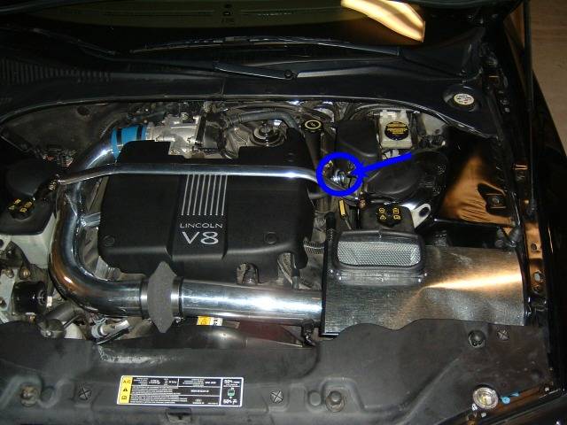

I believe it's a little chrome valve about 3" across - in-line with the fuel line and fuel rail - near the driver side strut tower.

Lou, that's the pressure regulator. The schrader valve looks like a tire valve. On the V6, remove the apperance cover and it's right there, in front of the valve cover.

Actually, There is no pressure regulator on the LS V8. Being that it is a returnless system, there is a pressure sending transducer located at the inlet of the fuel line (bank one rail). The transducer monitors fuel pressure in accordance to engine vacuum and increases or attentuates voltage at the fuel pump. Being that it is a returnless system controll by voltage, the round canister pictured (circled in blue) is actually a fluxuation damper. It is there to prevent sudden spikes in fuel pressure.
The schrader on the V8 is located midpoint of the bank one rail. Aiming upward towards the hood. But, just a quick tip....... I take it if you cant find the schrader on your engine, you dont have a fuel pressure bleeder/gauge anyhow. So make it easy on yourself.... Wrap a rag around the fuel filter and disconnect the line, it wont spray and all the fuel will be soaked into the rag.
