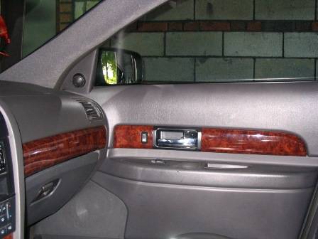

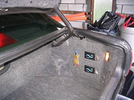

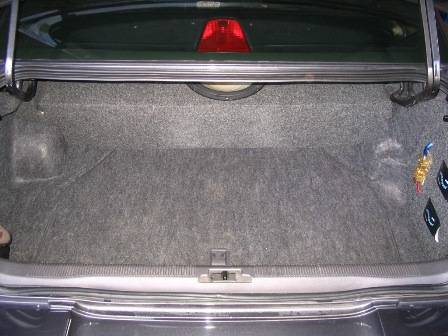

Here is a before and after of the trunk as well as a shot of the components in the door.

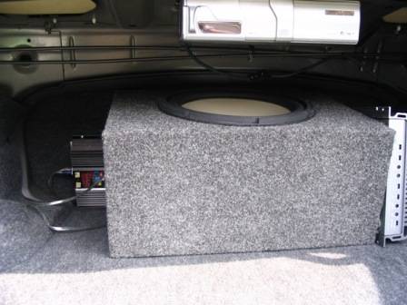

The sub is facing at about 45 degrees up and back. Didn't notice a single difference in sound front straight back.
You can easily get away with leaving the 40-half of your rear seats un-blocked. Not sure what kind of Bass you want, but for me, 1 12 is more than enough. This Infinity works in a 1.25 enclosure.

do you have more pictures of the right side of your trunk? I can't tell but are those crossovers? how did you fab that up... thanks, i was thinking of doing the same but with an amp, how did you connect it to get it to stay in place. looks good.
Thank you.
Yes those are the crosses for the components.
That 3 sided piece of wood is cut to just the right hieght so that it wedges in under the rear seat latch support. Trunk on the bottom, rear seat lever support on top. Pure friction. Has never come loose and that piece I did 8 months ago. You can definately put an amp there. I was going to put my V12 there. Right above the battery too.
Here is another shot.
BTW, one issue is that the trunk light gets impeaded from doing its job. I plan on adding another light in the middle.

Same box as the 1st pick. Just some plywood covered with carpet.
I'll get the dimensions of the corner box tomorrow.

How hard was it to place those tweeters?
The crossover box is 13' wide, 15.5 high, and 4' deep.
I'm sorry, I don't have specs for the sub box. Like I said, the box is standard 1.25 cub 12' box with side panels I've added.
The tweets were not that tough. I think that is the best spot. for them Just a small hole in that piece which worst comes to worst can be replaced cheap. Plus a nice location for sound imaging.
