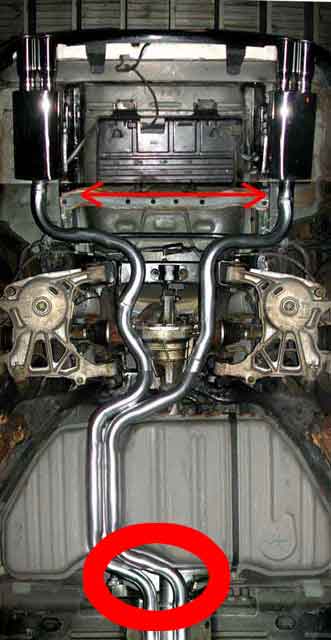

does anybody have pics of the exhaust setup for a 95 mark 8 i saw the pics of the 97.... want to show the local exhaust shop what it really looks like... should be getting my MAF and the rest of the exhaust from Geno in couple of days ... got the XX pipes yesterday!!!!! thanx GENO

All the same 93-98.
The layout is the same but the measurements are not. A welded up Gen 2 exhaust system can not be fitted to a Gen 1 and vice versa.
Geno you should've been at the exhaust shop yesterday :) Let me highlight the sections that do not fit.
At the <---> arrows, the distance is shorter for a gen 2, longer for a gen 1. the mufflers will not fit in the cut outs without longer pipe.
At the circle, the bend in the cutout on the gen 2 is longer than the gen 1, so you need shorter pipe.
Thats strange as hell. We lopped off a Gen 1 set up we did for a good customer Mike, and we installed it on his Gen 2 (after his Gen 1 was T-Boned) and it went right on. We did cut the pipes about 6 inches before the mufflers because he went with the Gen 2 twin tips over his ovals that were on it. The pic is still good for a reference for the exhaust shop to use. We send a copy of that pic with all our exhaust systems.
