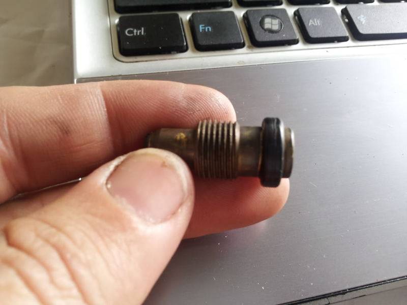

Mine did the same deal , turned out to be a brass hex plug that screws in the upper intake on the underside just infront of where the throttle body bolts on .
Found the plug with oring on it laying on the pasenger head on the valve cover .

Here's the funny in this whole situation. When I removed the intake manifold I saw what I think was that bolt. I didn't have my magnet tool to grab it and I wanted it out of there so when I took the intake off it didn't drop into one of the cylinders. In my efforts to grab it .. it fell into the little valley between the head and the IMRC plates so I thought... well.. it isn't going to do any harm there and went ahead with the gasket replacement.
Now, after seeing these posts I'm kicking myself. I've tried to grab it with a magnet but I can't even see it any more. It's way down in that little valley... I called ford and the part is discontinued and there are none in America at any ford dealership.
I guess I'll take the throttle body to home depot and try to match a bolt up to the whole.

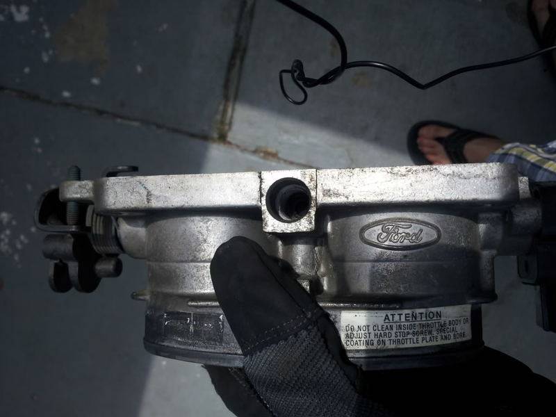

ps: I haven't taken the throttle body back off to confirm this is the issue but I felt under there with my finger and felt the depression where the bolt should go.

Buying an entire throttle body for a bolt is a bit extreme. I think a rubber gasket and shaved bolt from home depot will do the trick ( I hope ).

What do you mean by "get it set correctly"?
Well, my original was not seated completely into the hole. I spoke with some who believe that the 'permanent' factory setting is not completely screwed into the hole. Others have said that they just screwed it all the way in and loctited it. My idle was too high with my first attempt, so I took everything off and tightened the screw some more. The computer was then able to make adjustments.
10.00 shipped for the plugs. I just checked and it wasn't tight. I have at least three of them in case other want then too. Pm sent for paypal details.
The ebay/ paypal account is my daughter ... mona is weird, nick name since a baby lol.
Yep, that bolt was missing. Thanks for the service racebronkco2 very quick. Torqued it down a bit but no locktight at the moment. Once I get some I'll put it in there for good.
It says not to adjust. I just screwed it all the way in. How is it supposed to be put in there? Does this have something to do with the idle?
