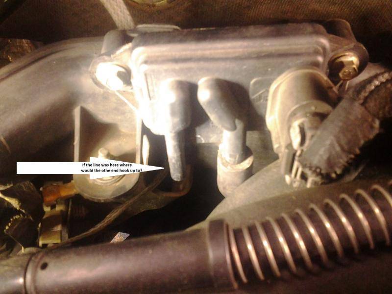

It keeps throwing a P401 code *P0401* I was going to replace the EGR Pressure Feedback Sensor also known as the DPFE15 when I got ready to replace it I noticed that there was a vacuum line missing, it's the one on the left it says REF the one on the right that says HI it's hooked up
I need to know where the REF line hooks up on the engine?

Try to look behind the motor to see if the line fell back there if it's completely missing. Then you will see to lines coming off the the EGR valve you will have to remove the cowl cover and possibly the the brace to see the pipes it connects to.
