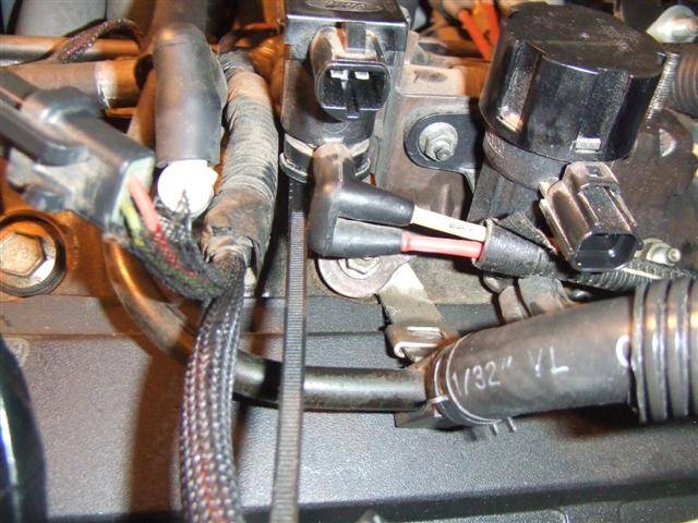

OK Hotties....I pray that once I am done, I can say changing the plugs and wires is easy....cause it is not looking that way now!
Finally after going to get yet another socket adapter for the last bolt, nut, screw.. whatever the H E double toothpick you wanna call it, I've worked my way to yet another cover....grrrrrr....got that off on the left side, but the right cover has a few gadgets blocking it. The one piece looks like a push and slide release...but no pushing happening, do I unscrew it also?
I gave up last night, frustration and exhustion got the best of me after I needed the adapter for the end of the intake.
Any one got any advice...I'm giving myself about 10 mins to chill out then going back at it....
The culpret is the bolt lower center of the pic, (only see half of it) it has the metal piece under it that semi-twists to what looks to be a slide release for the black hose (stamped with 1/32"), which is what I need to remove to get at the plugs.
Any one got a second to enlighten me? and there is nothing coming up when I do seraches (spent two hours trying yesteday).
Thanks!
MsM8

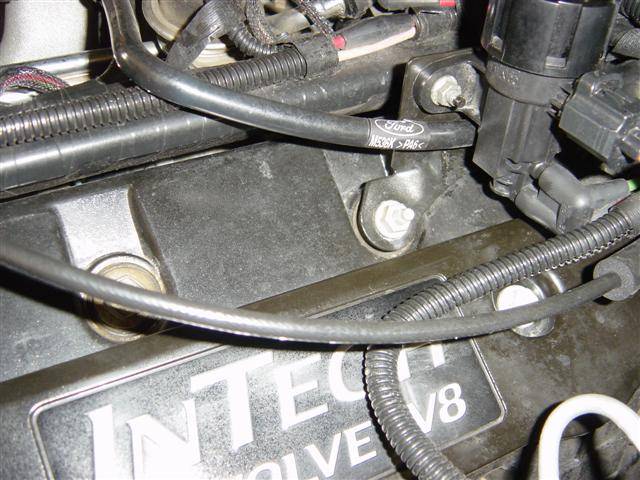

I would give ya a hand but cant make the 7 hour drive today :) wait till the meet and we can knock it out in about 15 minutes for ya.heres what a gen 2 looks like-just take the top nut off and move it to the side to get the cop cover off-or the wire cover on a gen 1

Remove that vacuum line and you should be able to put a socket on there to remove the nut, remove the nut 5" to the left also and that whole bracketry will be easy to move out of the way. To try to remove that bracket off the other will be a pain on the car, you shouldn't have to seperate the 2.
ohhhh thank you! but the vacume line isn't in the way, it is the bracket with the red and I think yellow wired plug in the way.....and you mean there is another bolt down there.....gezzzzzzzzzzzzzzzz
Thank you thnak you thnak you!!!!

ok, I've got the left side done....Hi Hun, thanks for the "be careful", so I am right that bolt does have to come out and then it will release the silver bracket (holding the vl) so I can get that silly plastic cover off....ahhhh at least half done ;) ok....Im off, loaded with technical advice from the expert....anybody (RICH) gonna chime in with "have patience" lolol cause that comes in darn handy too....especially since the underbody just devoured the 10 mm socket....yes, it is the one that removes that little bolt that is keeping me from the plugs...I love my Mark ;) lolololol brb gonna check if my neighbors home..snag his socket....lololo thanks HOTTIE
