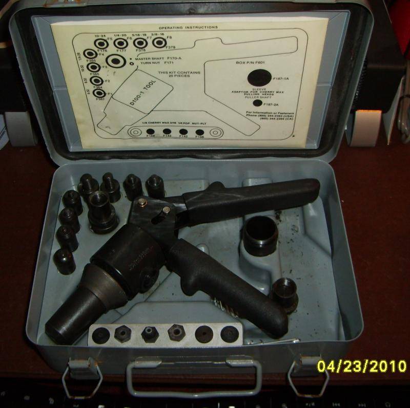

Most rivet guns available have multiple screw on tips, I have one and it comes with something like 15 tips, and it is hydraulic. I can lend it if you need it as long as you send it back.
where and how much for something like that....wonder if I could rent it from some where local
I got this yrs ago at a government sale on base one day, it is what we used in the military. You may be able to get something like it at a Northern Toll or Harbor Freight. But like I said previous, I can offer it to you as long as I get it back.
Here is a general idea what this goes for and this one does not have all the tips that mine has, do not think you want to pay tht kind of money for a single use job.
