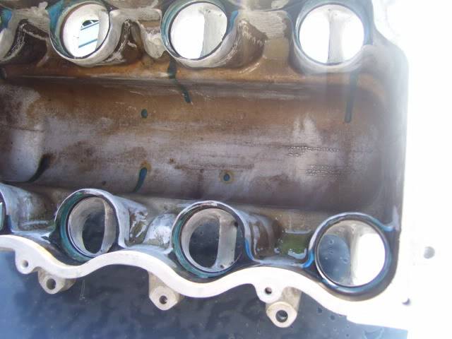

Here's a pic of mine with the runners out.
