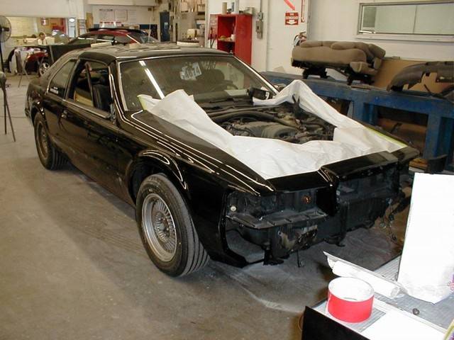

Here's a pic just home from paint shop... My new painted bumpers are still at the shop.
