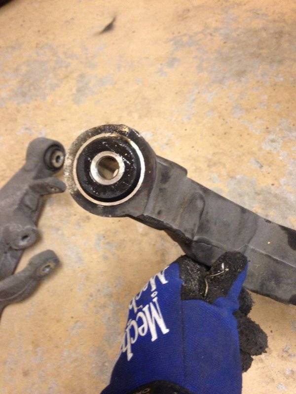

My '02 LSE with almost 200K in miles had started to really feel loose in the rear end especially on the highway with a cross wind. I had replaced the front tie rods and rear lateral bars, which needed to be replaced, had helped but hadn't eliminated the floaty feeling. By jacking the car up and using a crow bar, I could move the control arms around a 1/2 inch or so with no effort! I could have just installed the stock style fluid filled bushings but if I'm going to do it I might as well do these.
Well, I picked these up from Power flex a little before Christmas and had them installed at a local shop in a spare set of lower rear control arms that I had. With it being so cold I held off on actually installing the arms until this last weekend.

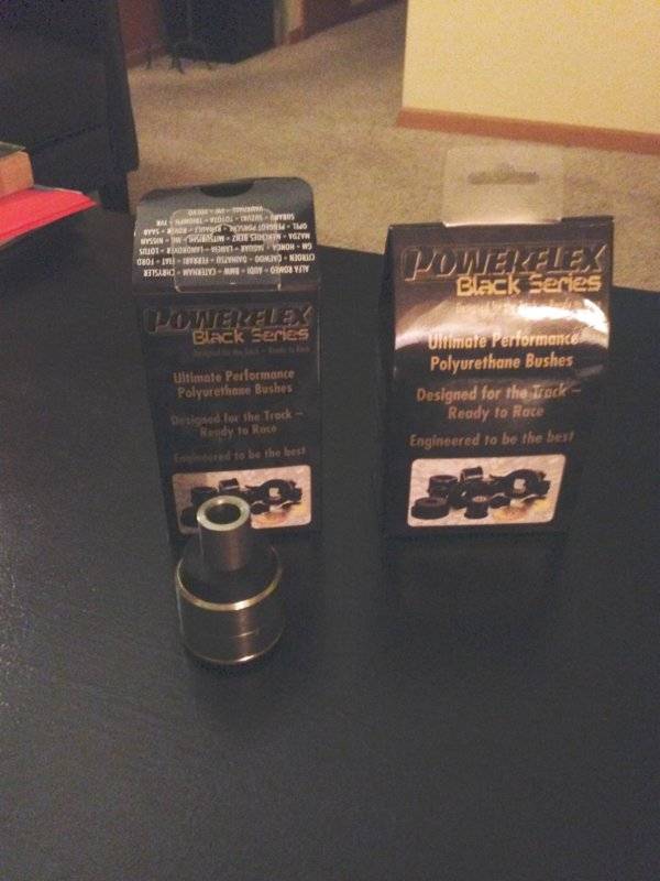

For those that don't know, Powerflex doesn't list the LS, but its Jaguar counterpart, the S type is listed. PowerflexUSA You have to use the bushings from the 98-02 cars which is a perfect fit at least for the 1st Gen LS, I'm not sure on 2nd Gen. There are 3 bushings for each arm for a total of six.
Jaguar S Type (98 - 02) Rear Lower Arm Outer Bushing
Jaguar S Type (98 - 02) Rear Lower Arm Inner Front Bushing
Jaguar S Type (98 - 02) Rear Lower Arm Inner Rear Bushing
The bushings I purchased are the Black series which is reported to be 90% stiffer then stock. If you have to swap bushings I highly recommend these!!

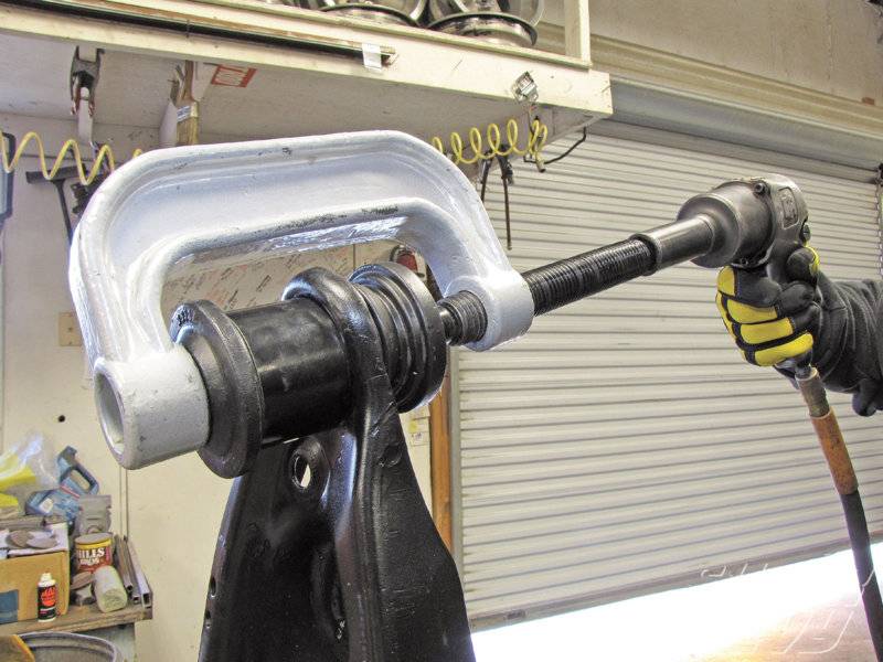

You can for sure, the guy that installed them used an air powered C-clamp type apparatus.

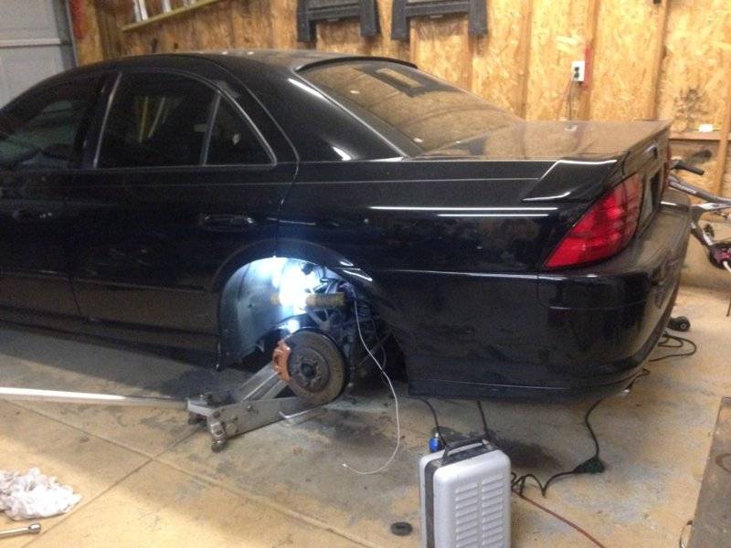

:D Ha! Yes it is. One cable was powering the light, the other the heater, My phone was running down while listening to the Black Keys so I had to plug into the light!
