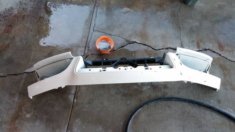

I am practicing on a header panel for my father, but it isn't going on a car, it is getting LEDs and going on the side of a shed for display purposes. It came out okay, and I learned a few tricky things that didn't come out good so I know to focus on it more on my header panel.

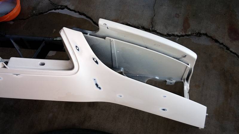

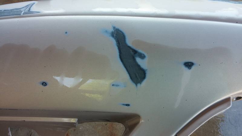

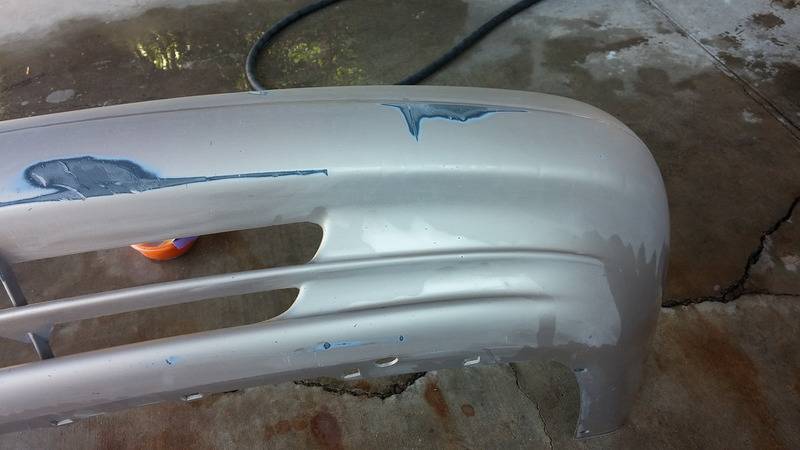

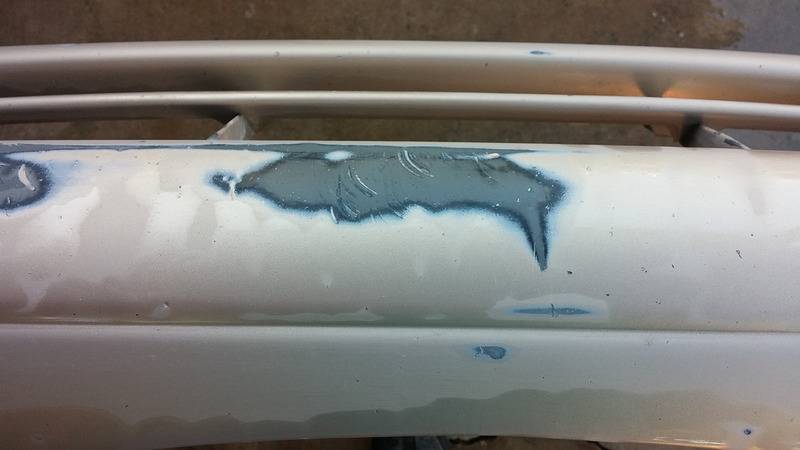

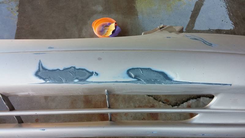

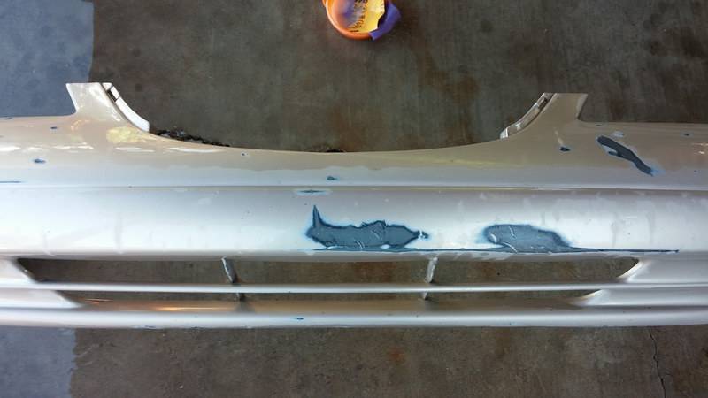

didn't remove the pin striping, and a rock chip I didn't feather out, plus it was gouged into the plastic pretty deep.
worst of the damage. I am not going for show quality here, but I don't want it looking like crap ir like a second grader school project:

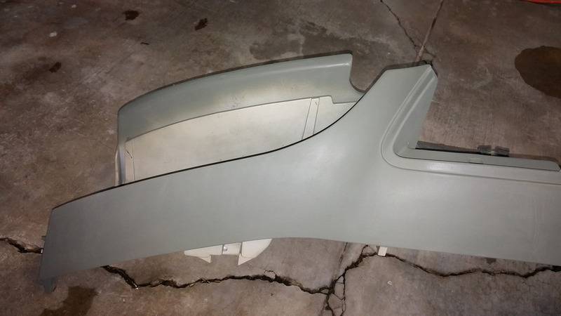

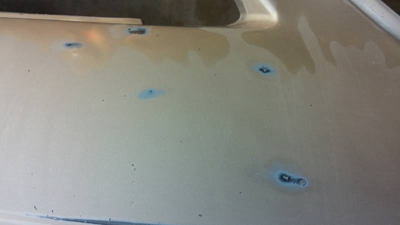

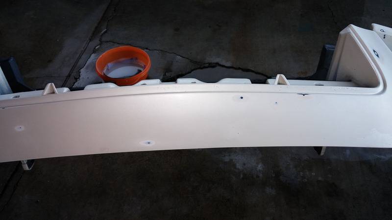

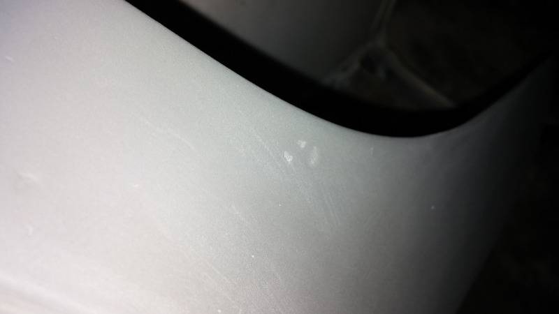

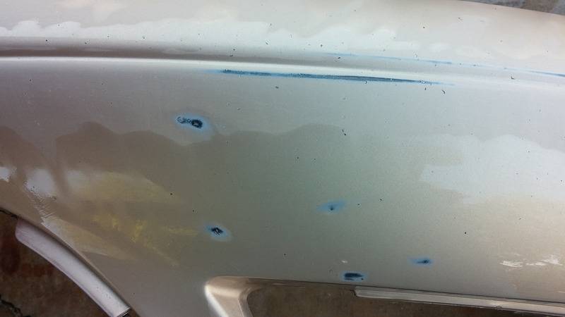

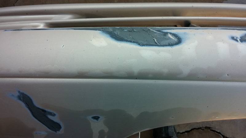

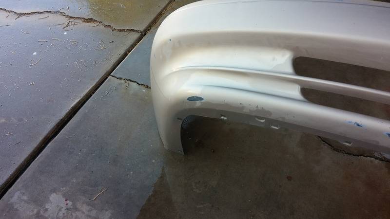

stone chips, about 10 of them

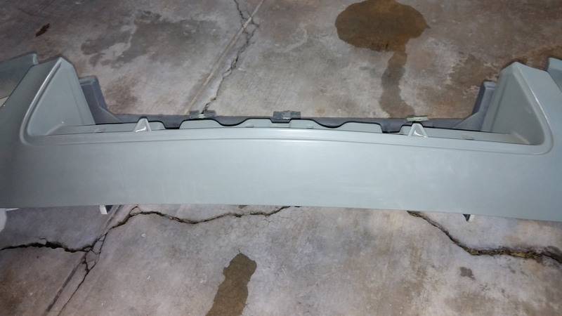

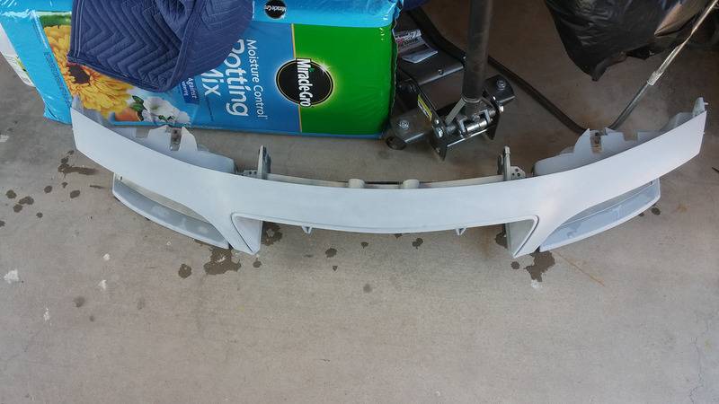

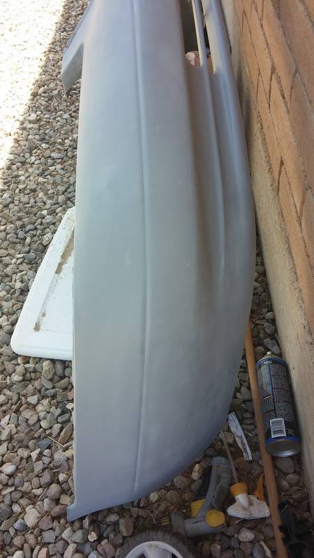

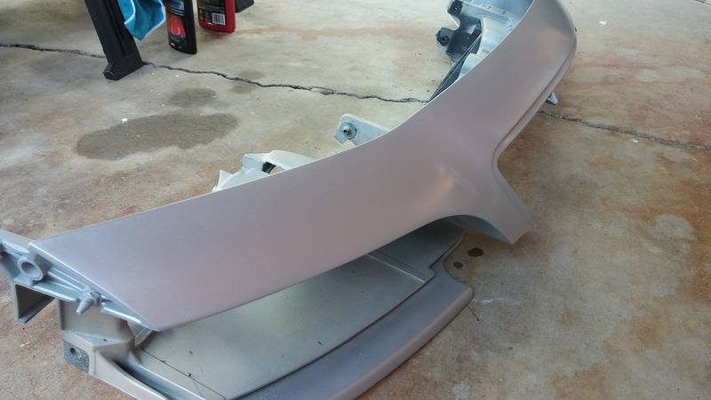

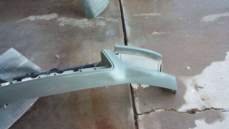

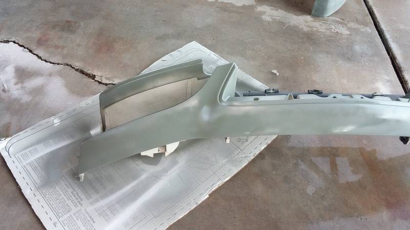

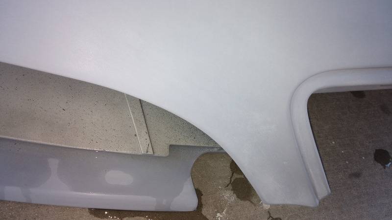

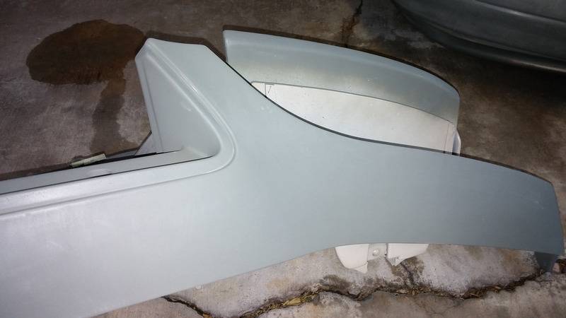

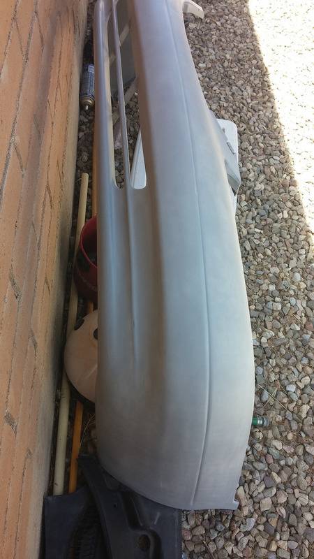

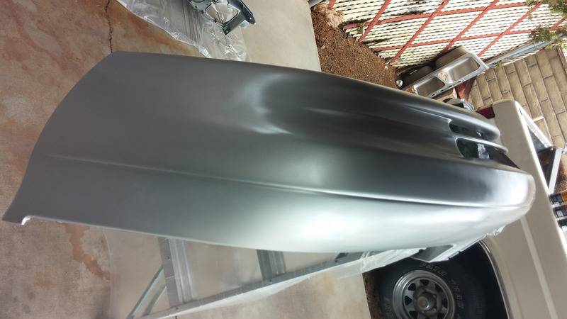

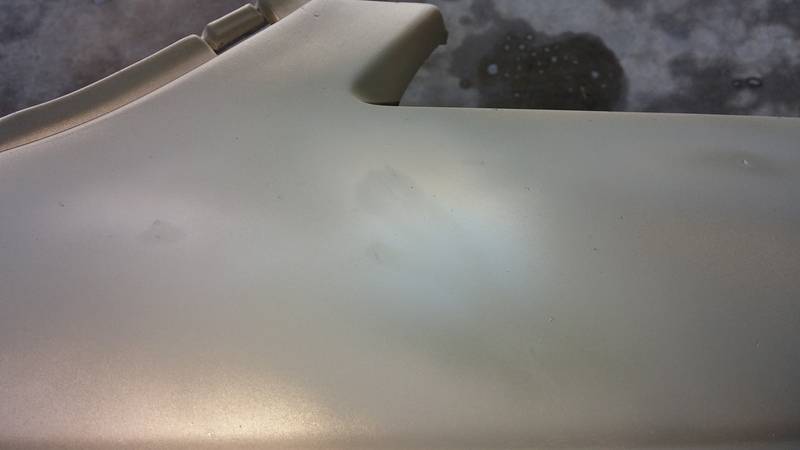

a few coats of an etching primer, just sprayed it, some is still wet, haven't sanded it yet
I think I want the surface to be smoother than this...

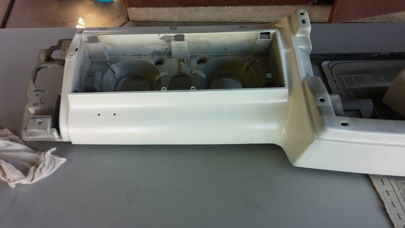

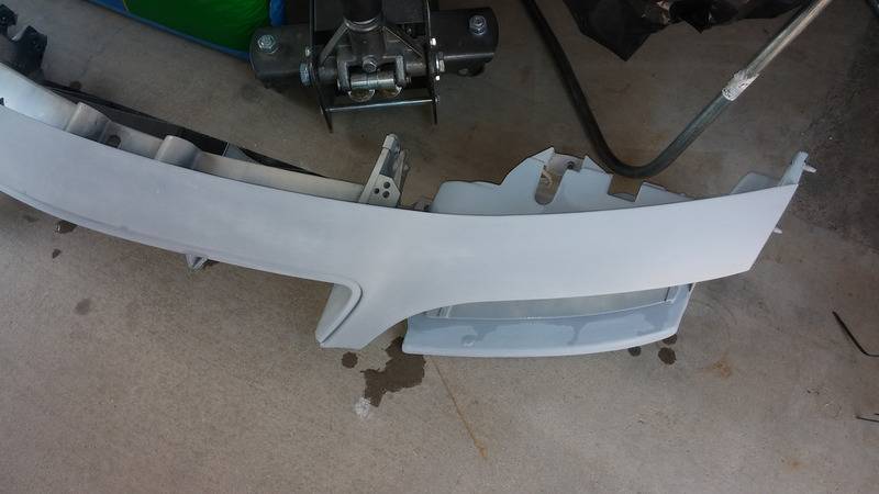

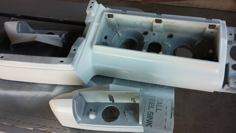

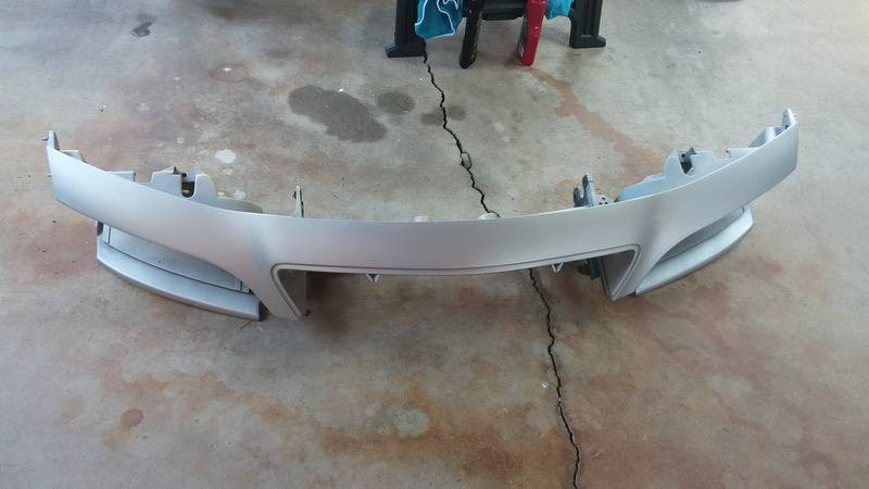

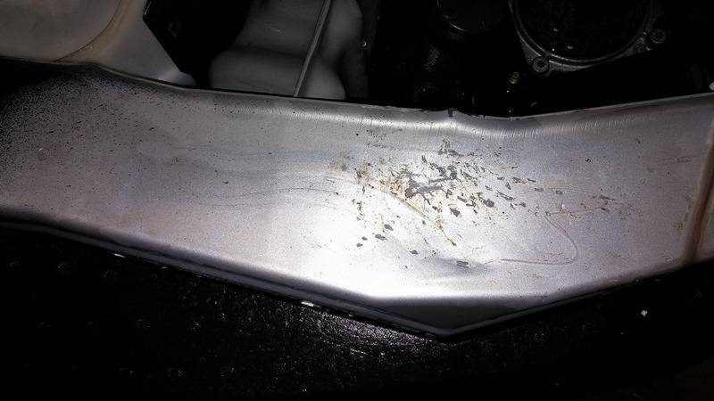

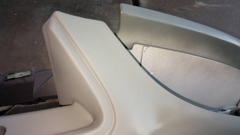

header panel, the two spots along the grille opening are pretty deep:
wet primer:

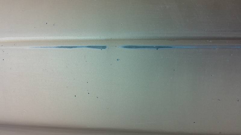

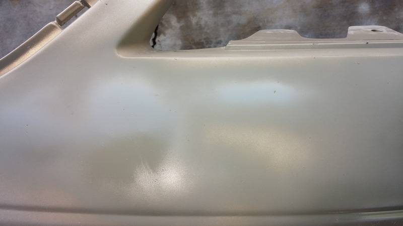

can't see the stone chips, but they are there:
sanded, probably good enough, but can still see stone chips:

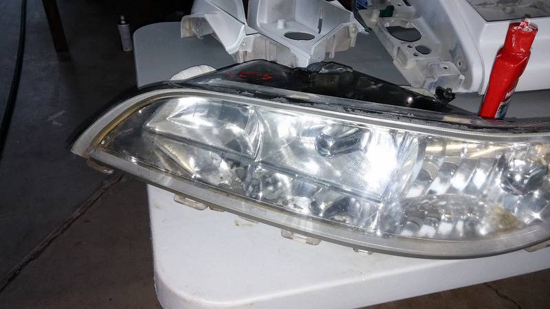

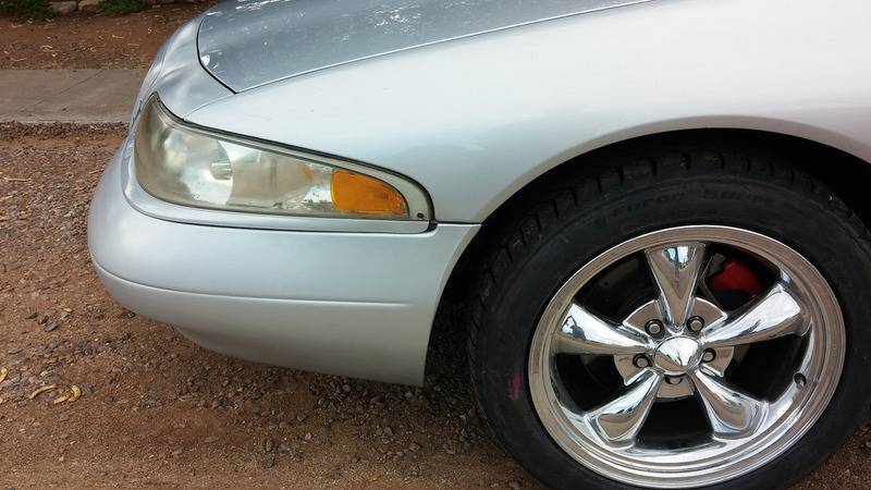

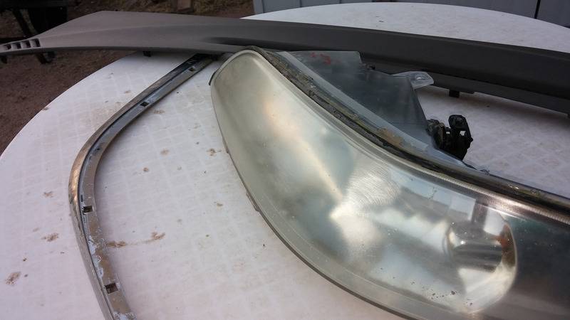

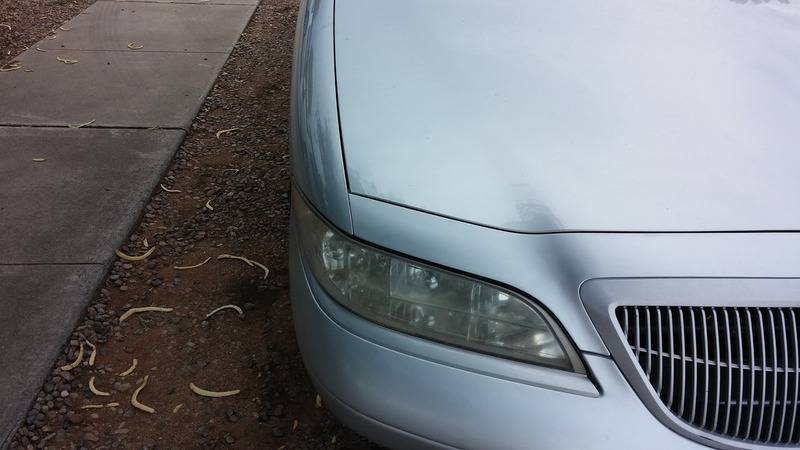

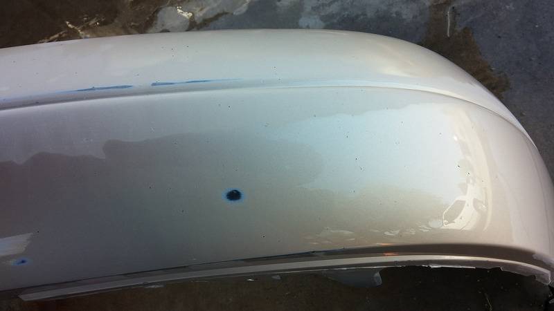

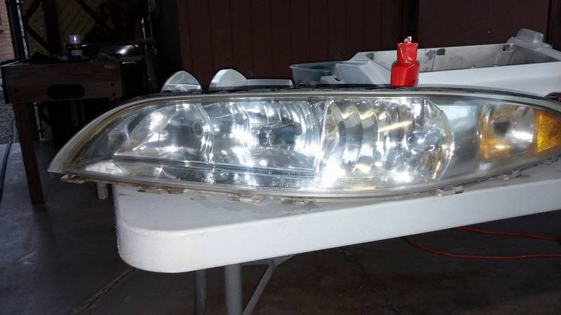

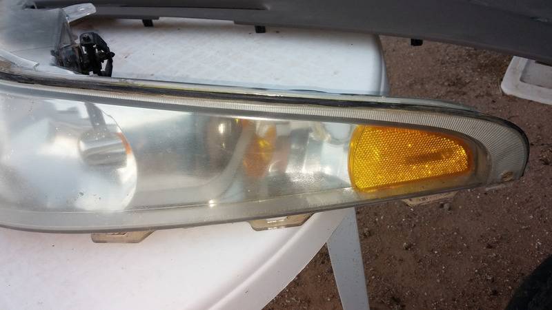

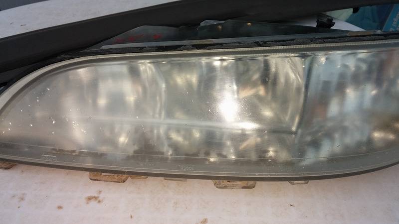

headlight, yes mucho f the silver is loose and covering the lense :(
20 seconds of polishing after 400 grit sanding (worn from sanding 2 header panels and an entire bumper):

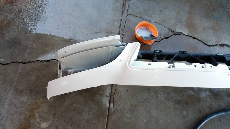

Got some Bondo glazing and spot putty for the cheese grater area and the down to fiberglass chips in the header panel. I will clean them up and use the spot putty there and in the pinhole chips. I feathered a few of the chips a little more, if I could see them on a wet primed surface or with it dry. I am sure the will be more obvious with the color coat, but I think it is looking pretty good.

I filled in the creases and chips with the Bondo glaze, I still have two to fill, but it is looking good. I also hit it with some high build primer and that helped with some scratches.

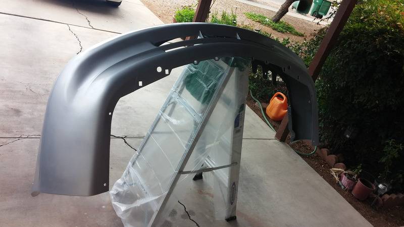

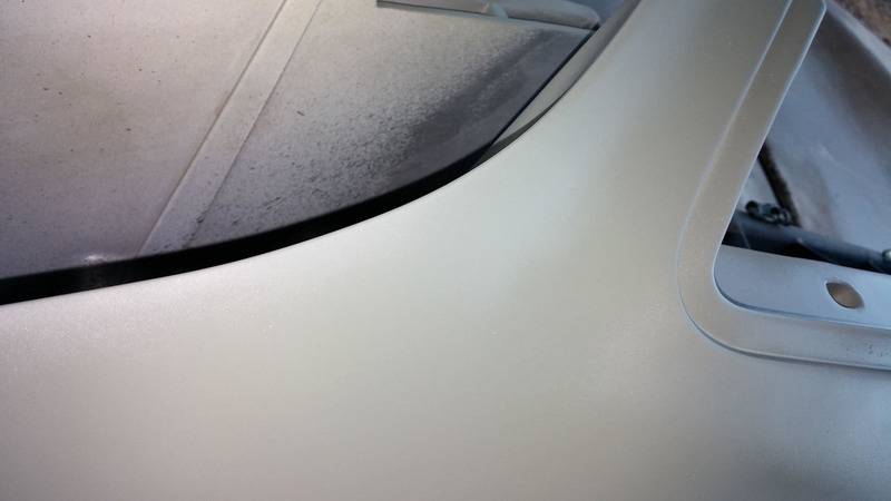

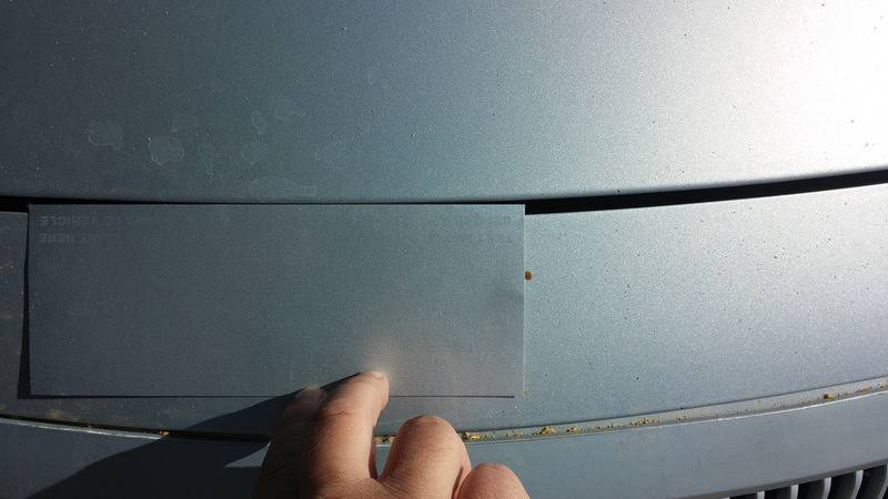

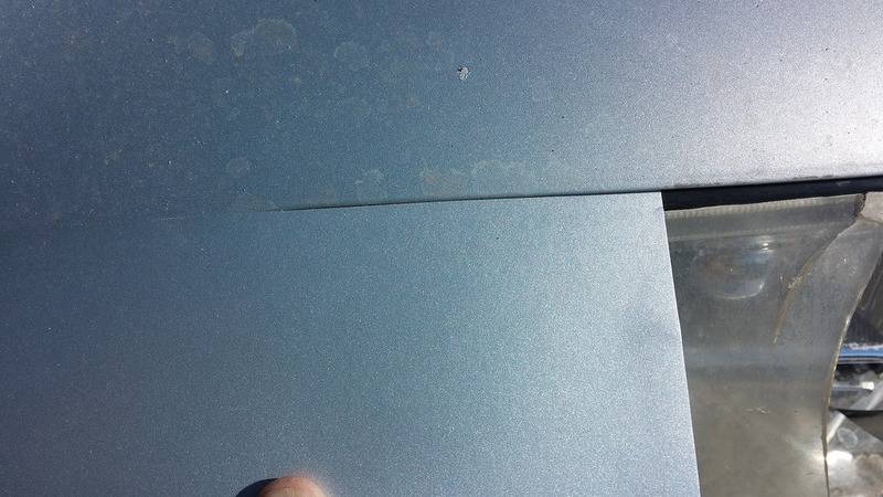

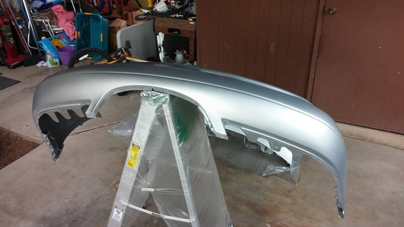

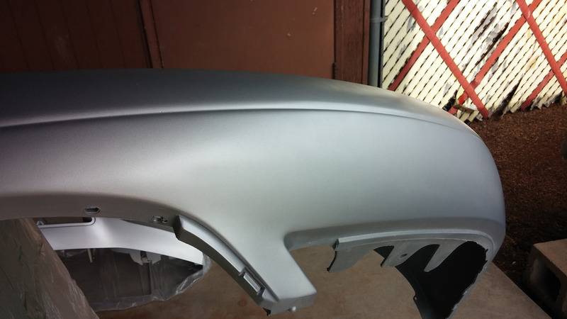

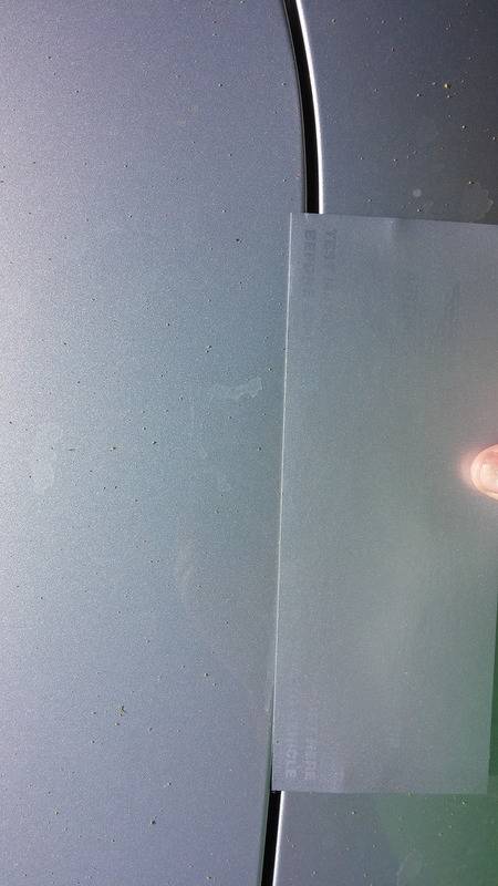

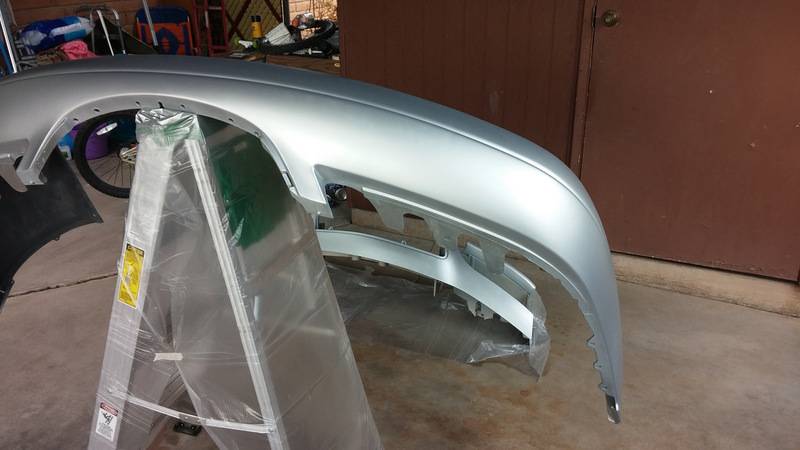

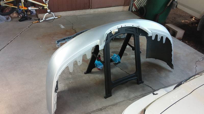

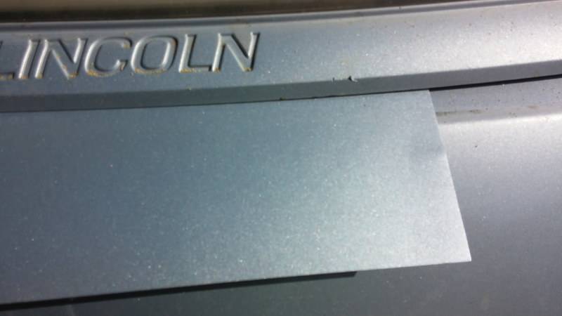

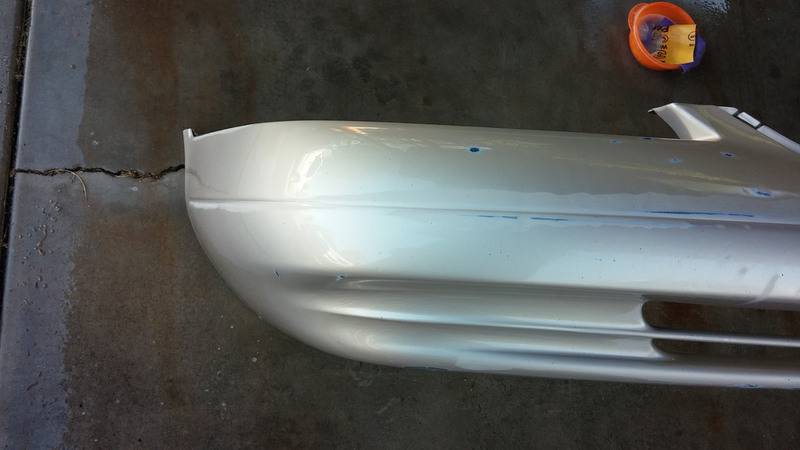

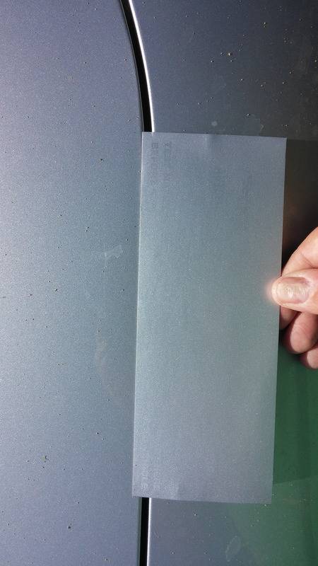

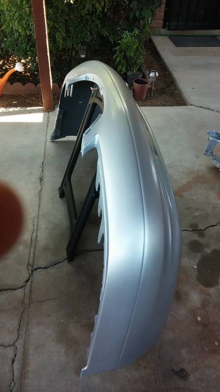

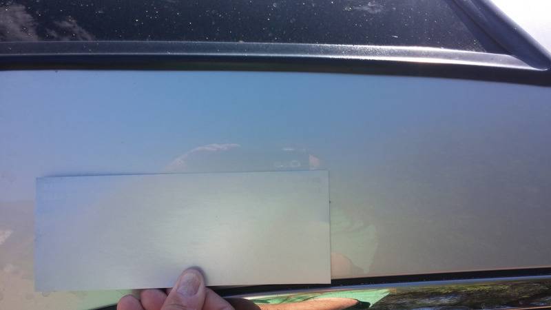

sprayed the test card, 1 tack coat, 3 light coats, and 1 lay down some flake from 12 inches coat, followed by 3 clear coats. I focused on the center of the card and not the white or black side, but I was still probably 1 coat of base away from where it should be.
As these pictures tell the story, it is windy and I have a ton of dirt and flowers from trees in the air, so painting the parts needs to wait until next week.

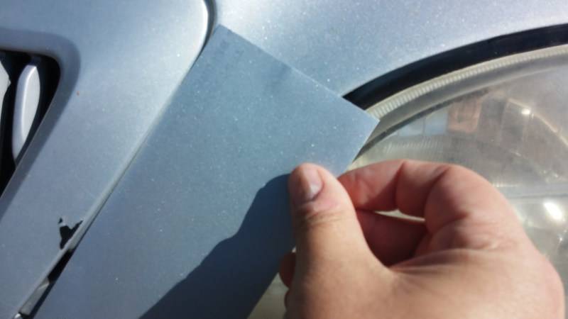

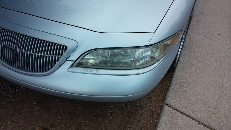

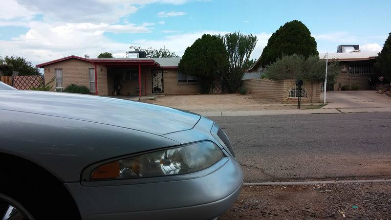

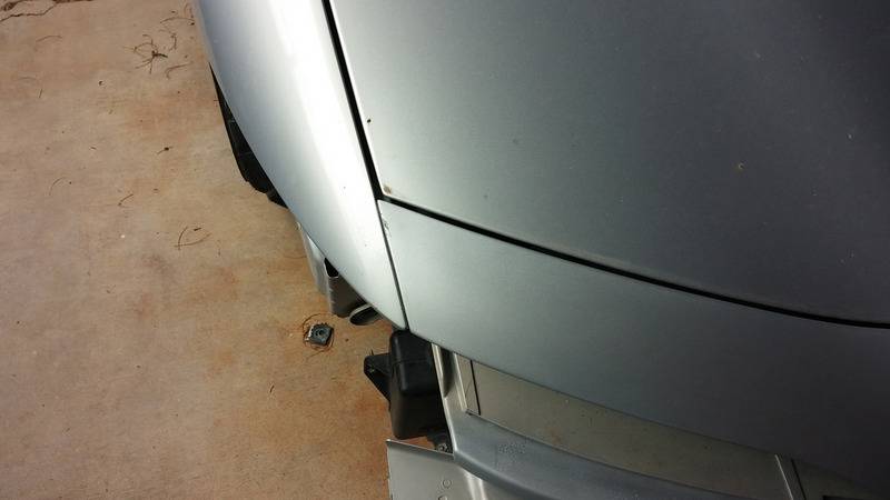

The grille currently doesn't match the rest of the car very well, I was going to just fix the two spots, but I think I need to paint it completely as well.
Hard to tell in the pictures, but the match is great, the clear isn't as glossy as the car, I also didn't sand it with 2000 grit and rub and polish it.
I'd say that's a darn good match. Looking forward to seeing the finished product.

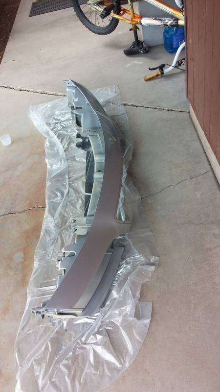

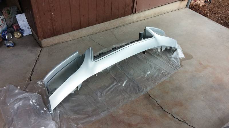

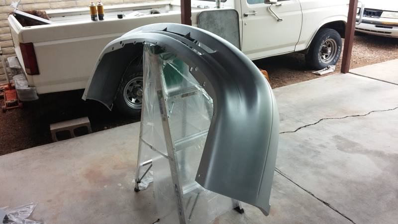

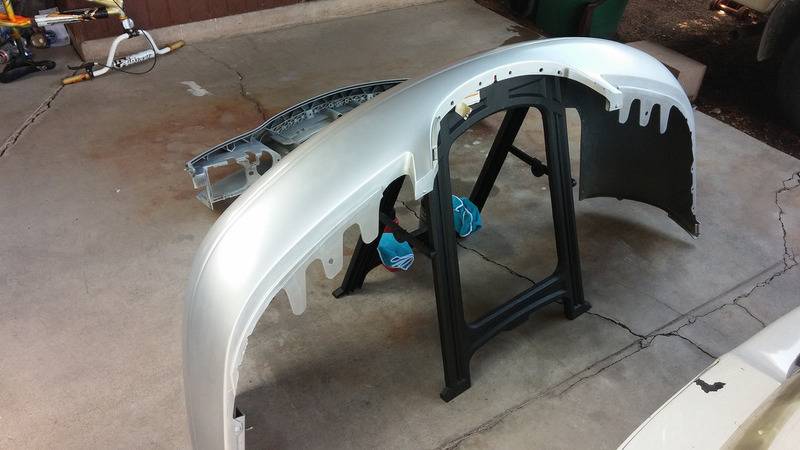

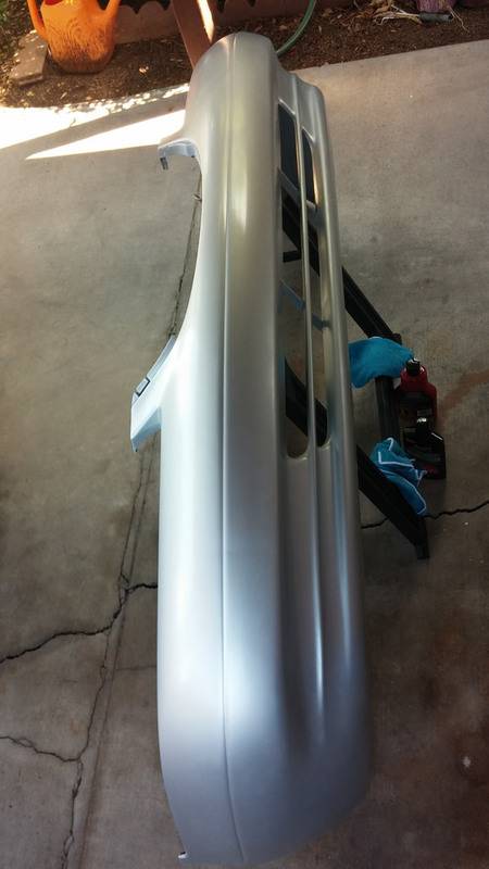

Got started at around 7 am. Hosed down everything with water (walls, roof, floor, etc)
went over bumper and header panel with a towel and denatured alcohol, then with a resin tack rag

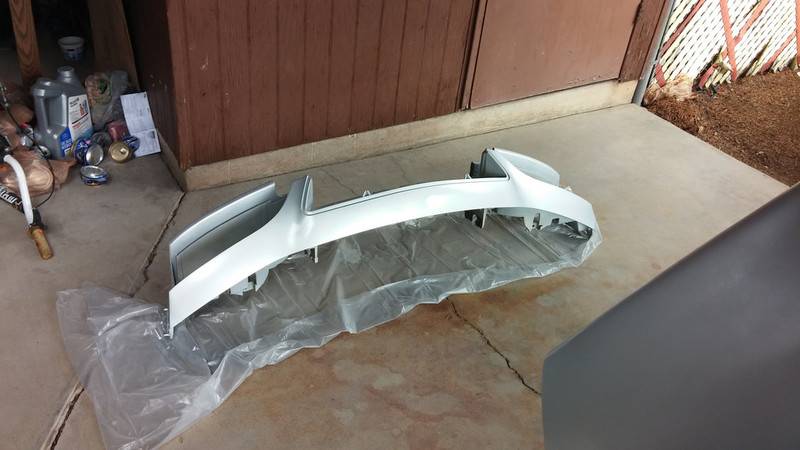

Laid down a tack coat, a very light and zebra striped coat.
SET A TIMER for 10 minutes (and walked away)
started laying down full coats. I put down 4 full coats, and just stepped away for at least 10 minutes between them

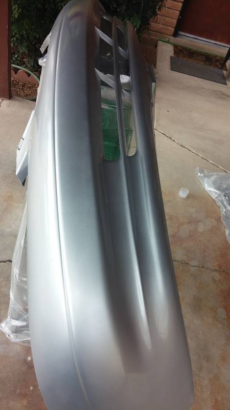

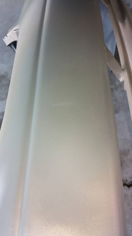

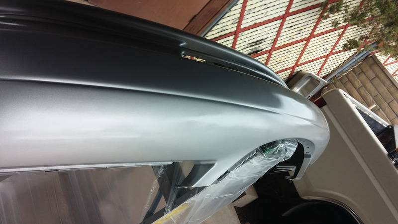

I then did a dust coat from a long distance away to lay down some metallic, I think I did this from too far away and it partially dried before hitting, but it did lighten the color a little and looked more like the existing metallic pattern on the car.

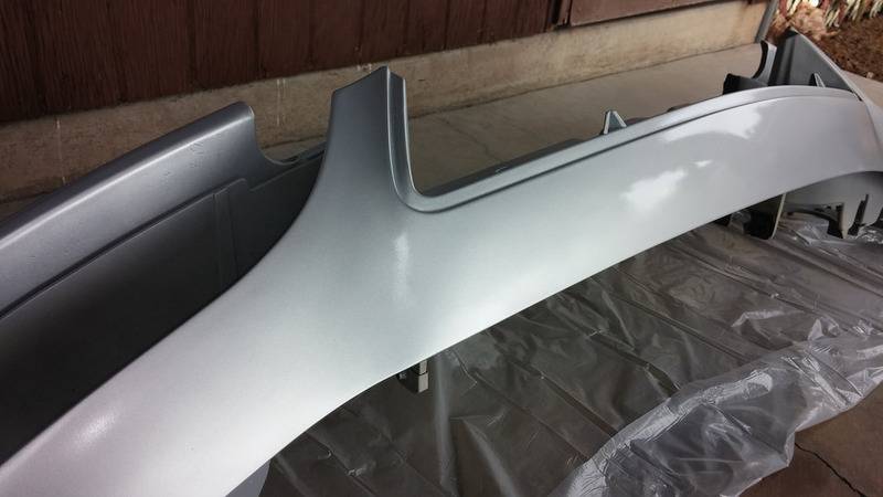

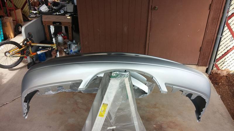

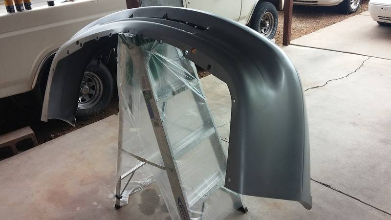

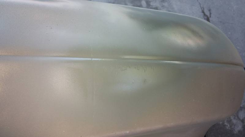

These are of basecoat only:
Some imprfections/debris in the color coats.
After the last base color coat, I waited 30 minutes (again, timer, and wander off), then drug the tack cloth over the bumper face and top and sides.
I put down 4 wet coats of clear, with 15 minutes between each
I let it sit for 30 minutes, then had to move it out of the carport, and it rained for 4 or 5 hours on it

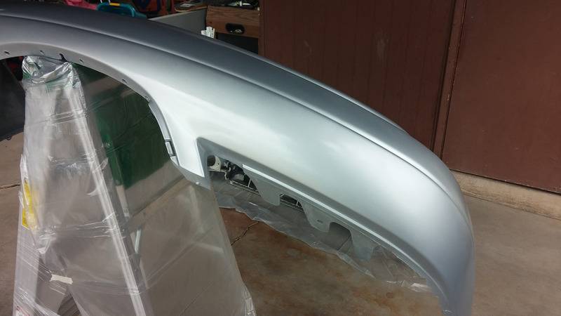

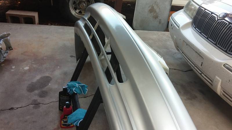

after waiting 24 hours I hit it with a light sanding with 2000 grit sand paper to smooth it out, get rid of the 3 places with small bugs, and a few places with orange peel
hit it with polishing compound, then with Mequires ultimate compound
Not sure when I will get a chance to install it, might take a day off from work this week.

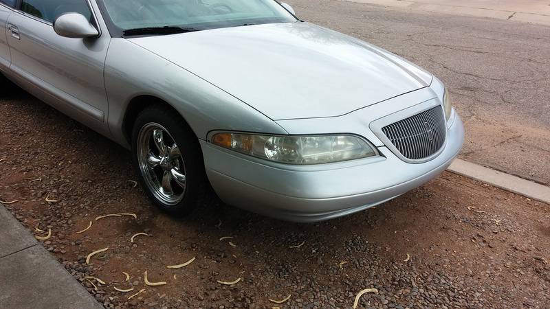

Overall I am glad I ended up doing it. The results look promising, I have held the parts up next to the car and they look good, but won't know until I install them.
From the $2000 I got from the insurance I ended up spending 225 (with some "waste"), and to be fair, no one would/could get the parts, so no shops would take on working on it, since I did the leg work to pull the parts myself, drag them around, I decided that I should go ahead with the rest:

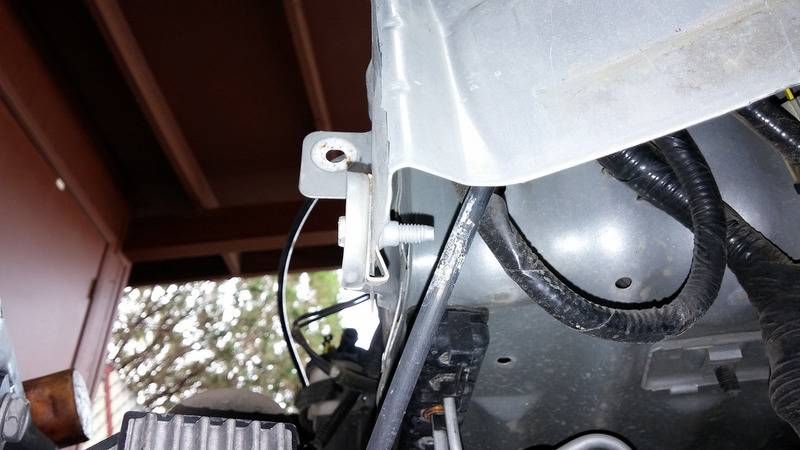

I still have to attach the bracket to the side where it mounts to the fender (I have a large rivet gun and rivets someplace, but I can't find it, so might get bolts) and get my wiring ready for the aftermarket HID (relay setup with resistors to stop the SCIL issues I have), and...time away from work.

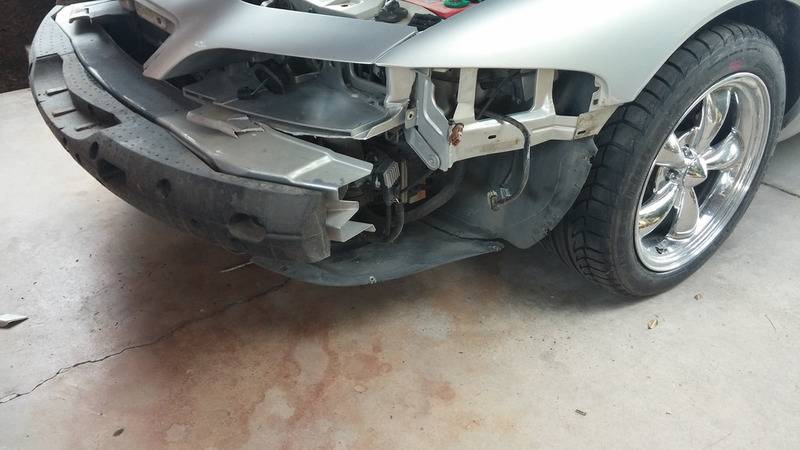

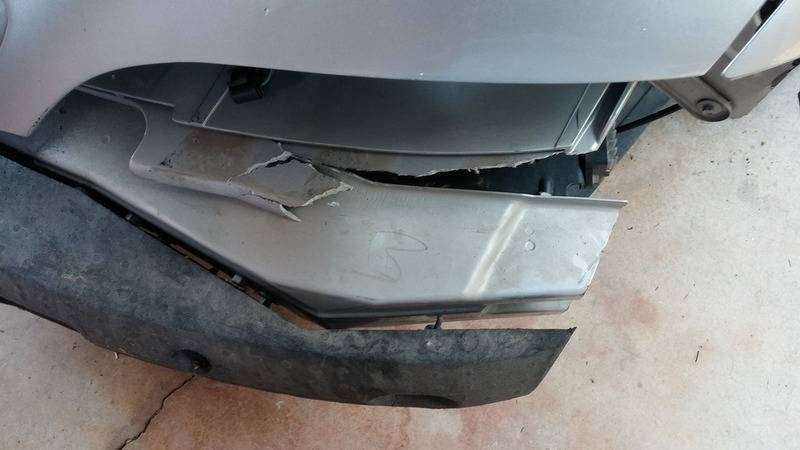

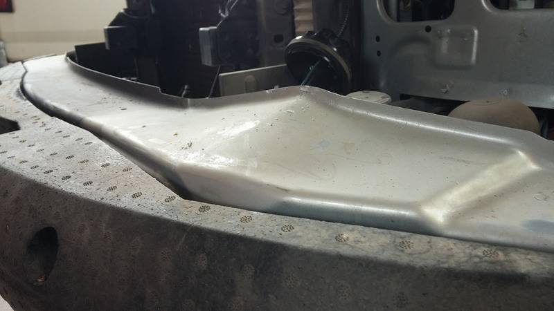

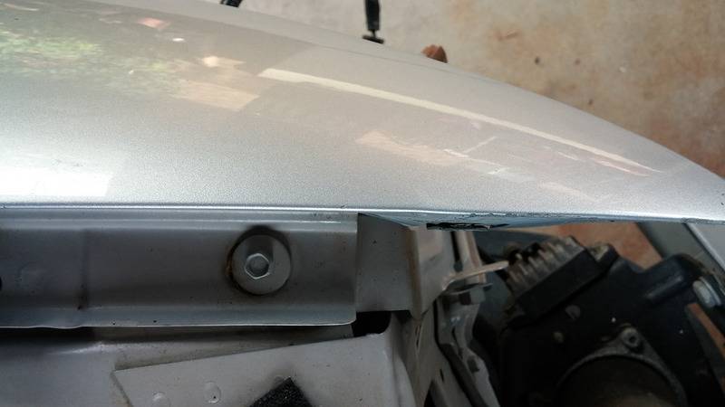

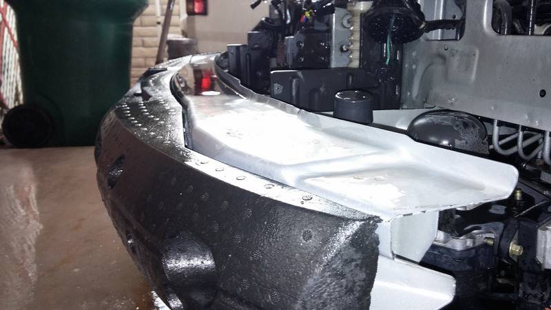

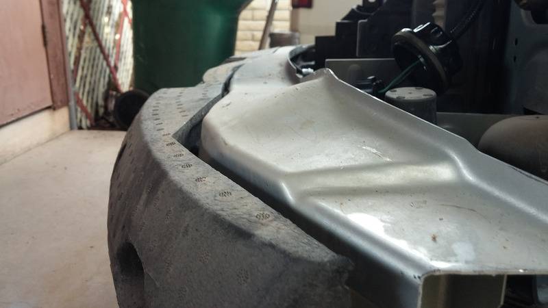

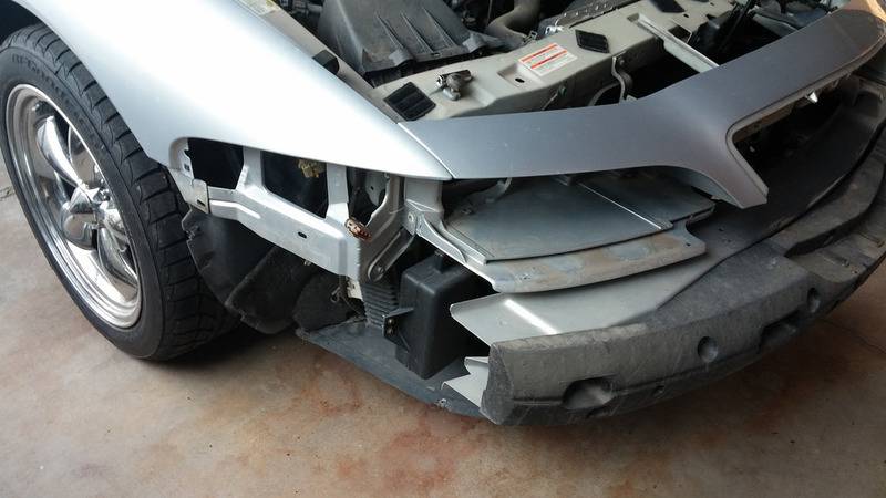

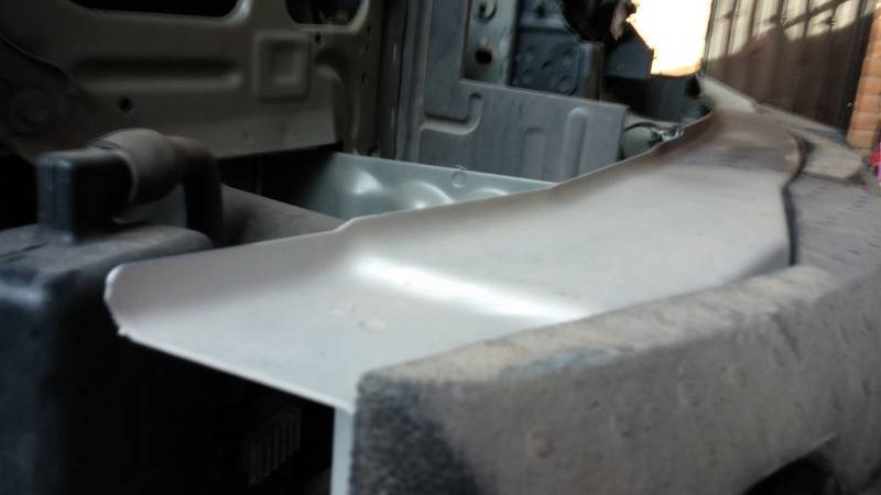

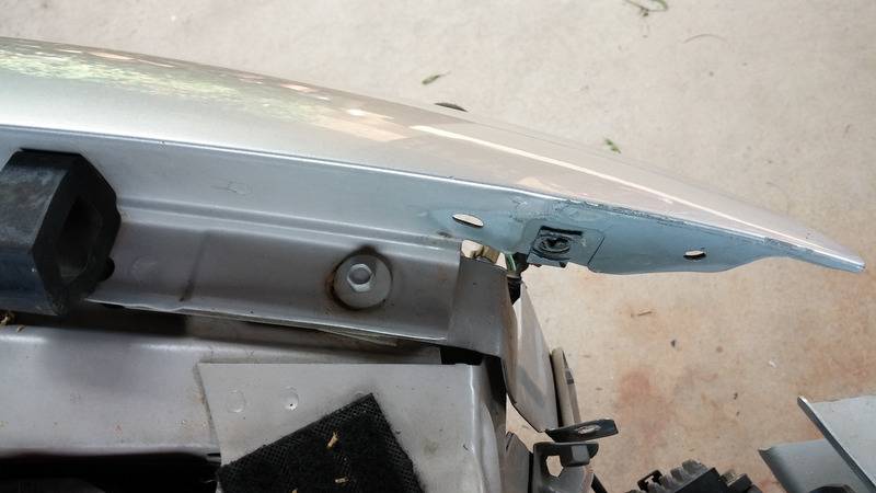

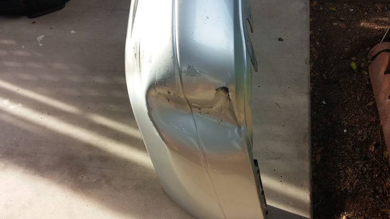

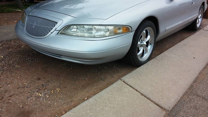

Bumper cover was pushed to the center a bunch, and cut on the metal bumper, I had the pry them apart. I also should have known what was to come...

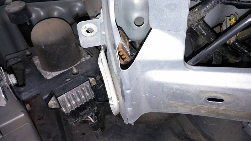

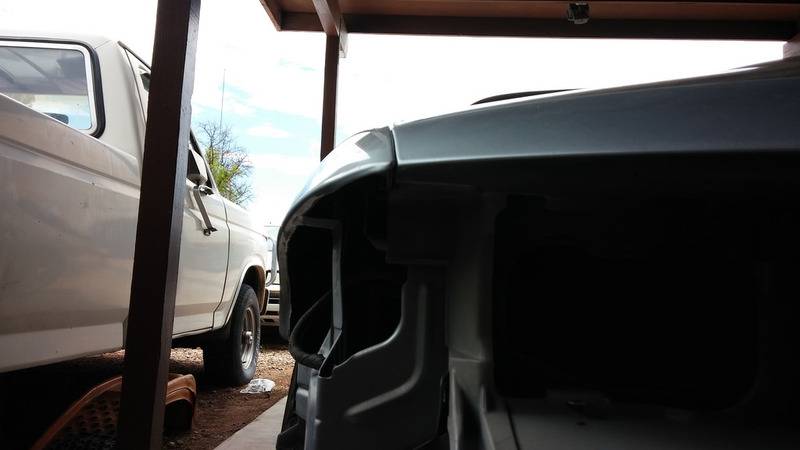

headlights and bumper cover off. I can tell that the bumper is bent because the header panel is under it...
yep...
passenger side
Already been quite a bit of bodywork done in the past, but it is bent from the header panel being pushed to the passenger side
passenger side, nice and straight but still looks like painting was done
back on the drivers side, fender front mount. That should be straight
10 whacks with a sledge hammer. Need to trial fit the header panel. Tried with a dead blow hammer, then a nailing hammer

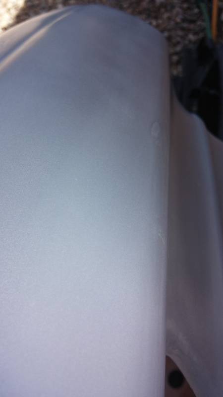

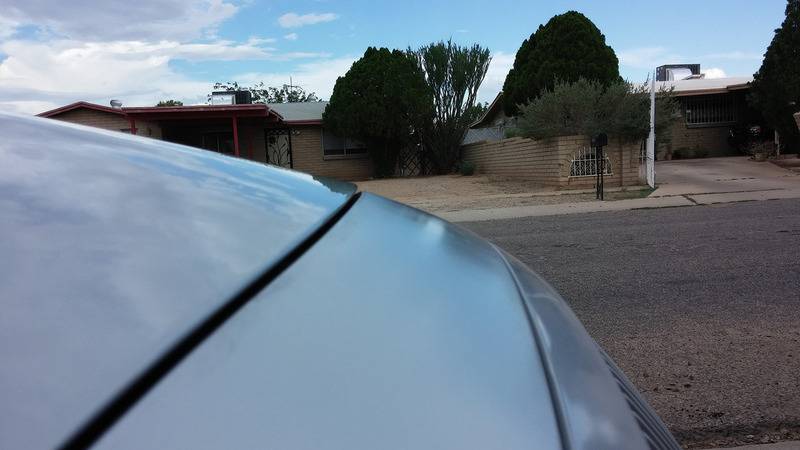

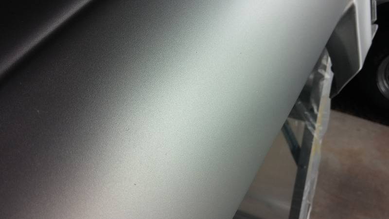

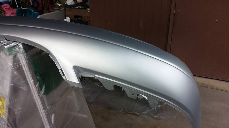

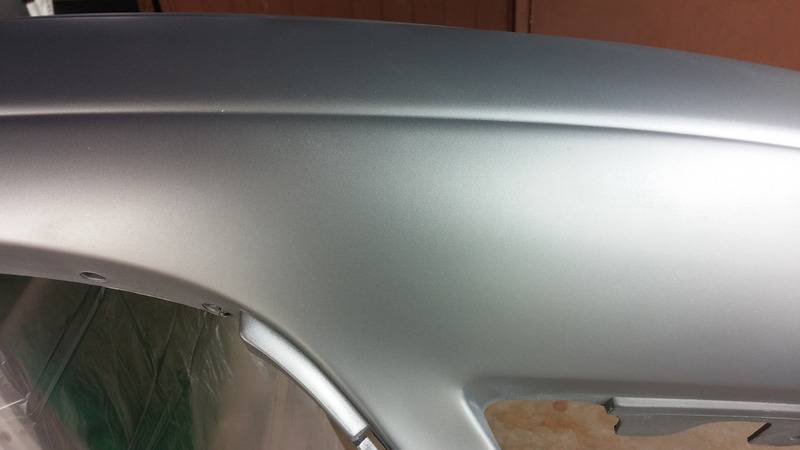

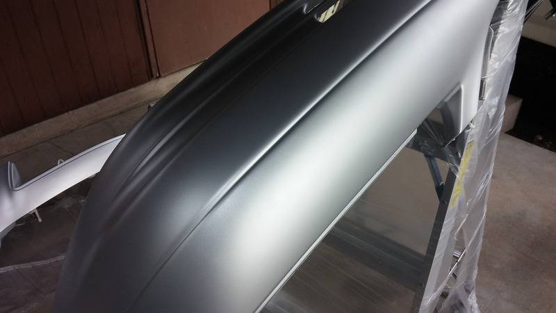

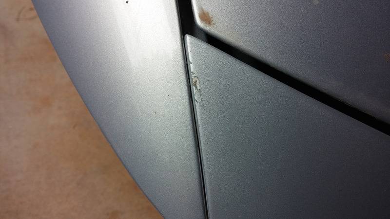

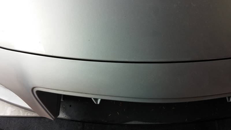

Not sure what happened, but from the time I finished painting it and now, the finish is now a matte finish and feels "soft" to the touch. I am not sure what to do. I very lightly sanded it with 2000 grit and hit it with polish by hand. It looked promising at that point, but 10 days later not so much. so On a scale of 1 to 10, I am being generous with a 4. If I can get it to shine up, maybe a 7. I still have some fine tuning to do, and I scarred the paint on the header panel. Not as easy to install by a single person as I though it would be, hard to know what is going on the other end when trying to be one side to fit.

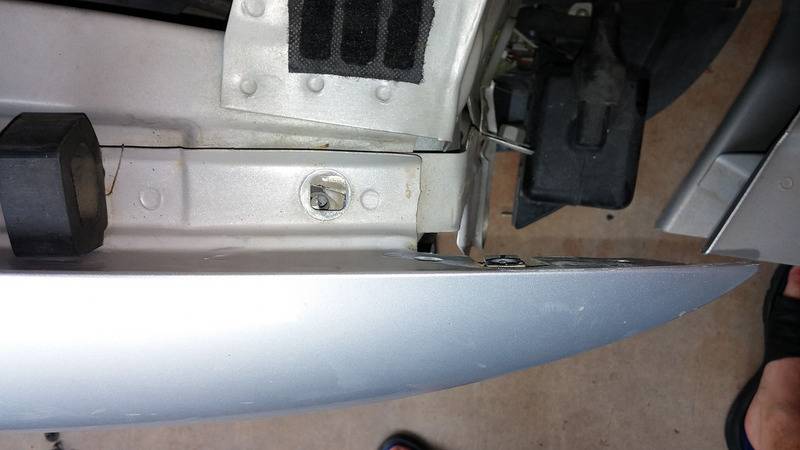

New header panel easily clears the bumper beat back into some sort of shape with sledge hammer. Lots more adjusting needed from this.

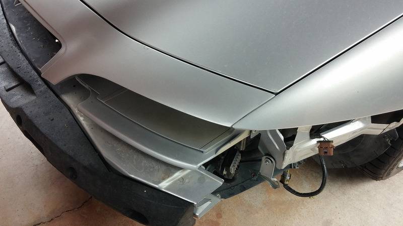

The gap seemed pretty good initially, just starting to bolt it down

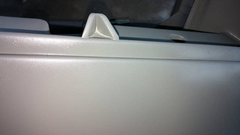

not so good, but I noticed in addition to all the broken header panel mounts, the brackets were bent (you can see where I caught the top of the header panel on the fender, (&%^*&^&*(^%&(

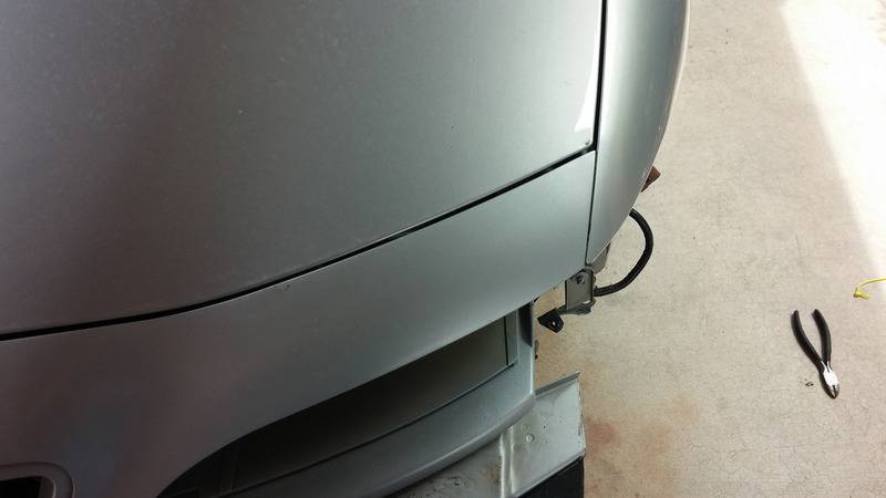

I still have spots on the grille to fix, I just flat ran out of time, and needed it back together, this is NOT the type of work that goes well with 1 or 2 hours every other day or so
not sure how to get the headlight to fit better, 1/2 gap is no bueno, and the trim is about 1/8 of an inch forward of where it should be on the bumper top
the center of the hood is 1/16 higher than the header panel, but the edges of the hood are flush, I guess time to bend to hood?
