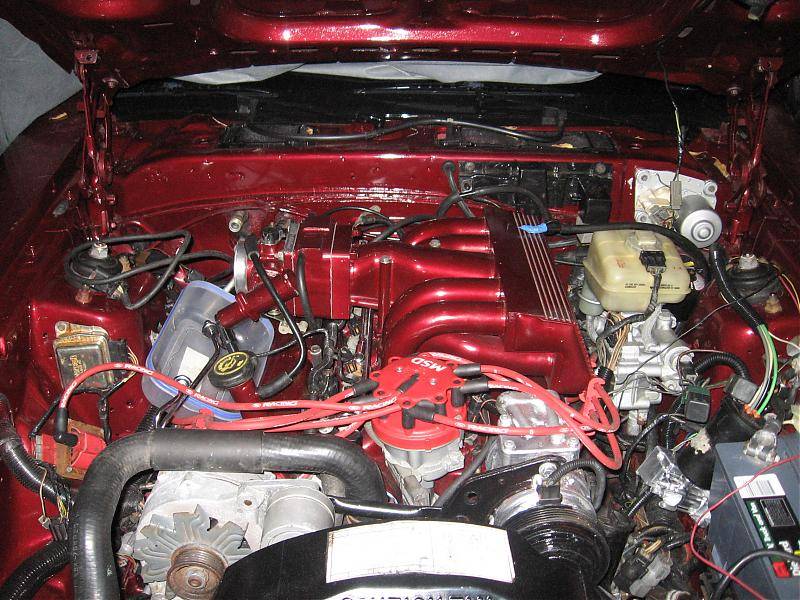

I installed a 347 in my 1989 Mark vll the engine will turn over but is not getting gas to the injectors . Ichecked the fuel pump switch in trunk of car and the buttom is pressed down checked the circuit breaker which has a red,pink,black and beige wires only getting juice from the red wire when car is in on and off position . Checker wires to the fuel pump no current and fuel pump is not engaged when car is cut no . Air pumpis not coming on only getting juice from one wire in air pump [the red one] no juice wire . If any one has any helpful feed back would greatly appreciate it.

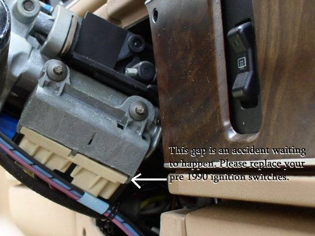

First thing I would check is the ignition switch on the column ,,not the key cylinder the actual switch
:shifty: Thank you everybody for your help. I get the car runing . It was the gasrelay under the hood. All relay.
