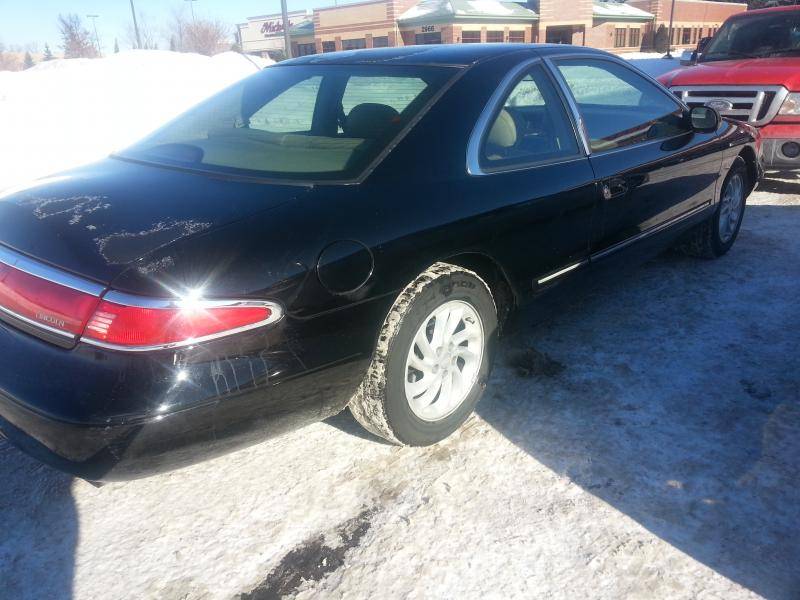

The previous owner was getting frustrated with 20mpg and rough idling etc,. high mileage. 250K. runs fair and shifts great. ride is converted from air to springs. so I got it for a pretty decent price. Black paint has some typical fading issues on bumper, trunk lid, roof etc..

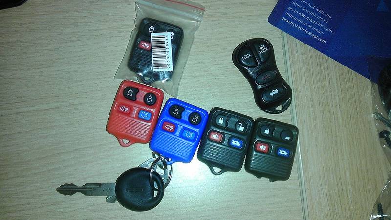

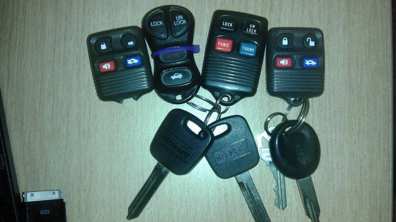

You will be happier with the square remote. It should be shorter than the one for the Gen I. I had no range with my peanut shaped remote, but the ones from my 2000 Grand Marquis (the square ones) are much better. I ordered colored cases (and a charcoal one too) from Hong Kong to replace a broken one, and to be able to pick them out easier.

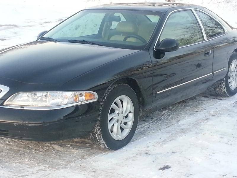

Just to be first, it will be worth 200 more dollars, get 5 more mpg, and idle better when the wheels are on the correct sides. :)

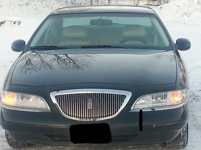

I am afraid to ask what you blacked on the bumper below the drivers side light in the picture with the obscured plate. :)
Lol I was waiting to see whod be first to point that out. Its been way to cold for me to change it over.
Itll happen soon. I have some better rubber to put on her. If not for the cold, we would get at stuff soonest on our marks sooner up here. ....can't wait for spring...as far as the black marks are, that was my first atempt using a photo editing tool on my phone.
