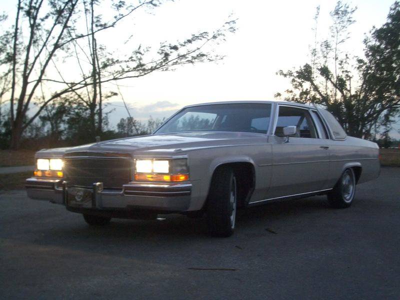

Hey, all. I'm new to these forums, and I've been poking arround on the site, and youve got some great stuff here. Anyhoo, I just aquired my second Cadalac about a month ago. I'm the proud owner of a 1984 Caddie Coupe DeVille, with only 39,000 Orignal miles on it! I work for a car dealer called CarMax- some of you might have heard of em- and recently, and elderly lady sold us her late husbands caddie. CarMax gave her the whloesale value for it- $500 dollars. And I ran back there and bought it. For $800. Anyway, its awsome, and I'm very proud of it, and I'm glad to be a memeber of the coumminty here.
So, here are some pics of it. Tell me what you think.
Please, tell me what you think of the car, and any suggestions on it would be welcome. I know its an old car, but did these have any major problems that I should gear up for?
THanks all, and I look foward to my membership here!
That's sweeeet! I'll give you $1000 for it. Seriously though, does it have the 4.1 engine or the 6.0? If its the 4.1 you may have some valvetrain problems in the future. The 6.0 is pretty bulletproof unless it has the V8-6-4 system which didn't work very well but can be disconnected so it runs on 8 all the time. All in all a very nice car .

Shes a beaut! If it was mine, I would get the Cadillac wire hubcaps that were available that year, it'll look much better!
Gorgeous car! Nice and understated! Love it!
