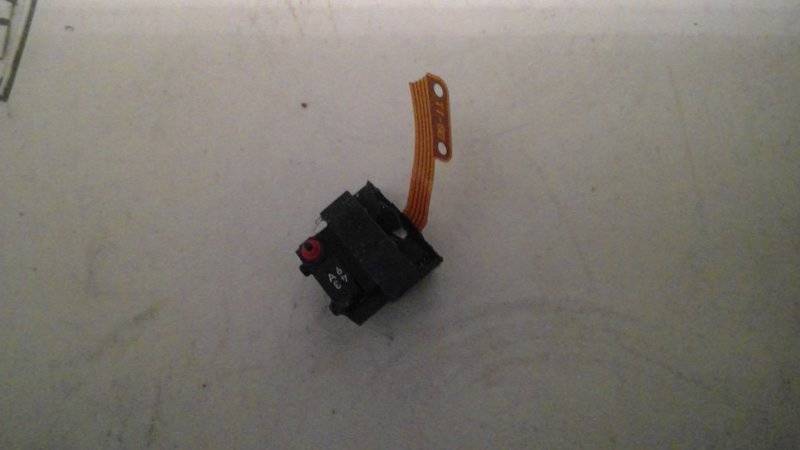

Well I only have one mirror hooked up right now and when i turn my car off the passenger puddle light on the mirror stays on and it will kill my battery.. what would cause this? faulty door lock assembly? my door ajar sign isnt on but it comes on every once in a while.

Found the culprit. it turned out to be the cable connecting the plunger to the lock assembly being torn. I must of done that when last time I opened it up. I sourced out a Motorcraft lock assembly for $60 brand new on craigslist near my place.
