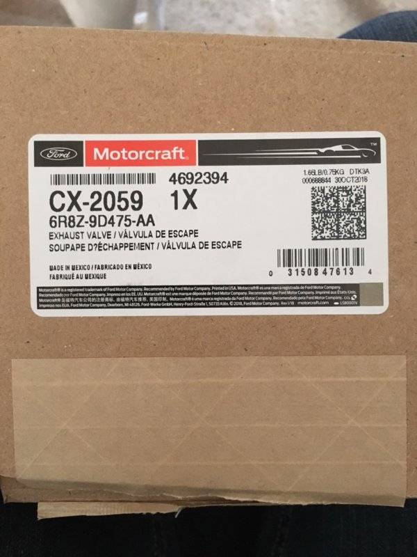

The link you posted is the one I ordered and it came in a motorcraft box that said cx2059 on it
6R8Z-9D475-AA is the most current correct part number for the gen II V8 EGR valve. I just ordered and installed one a month or two ago. (working fine)

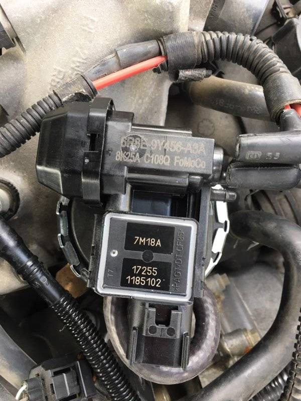

That was the part number on the box. I took pics of the box and the egr valve itself. I called my local lincoln dealer earlier to ask about it and the tech said its normal for the number on the part to not match the number on the box but that doesnt seem right to me so I figured id consult the experts

Yeah, I think that's the right one. I'll have to look at mine. I didn't really look at the numbers on the valve itself. I do remember that as the general appearance.
I think that where we may be getting confused is that the "6r8e-9y456-a3a" probably the part number for the solenoid valve that is one of at least three parts that make up the complete assembly, the sensor and the valve being the other two parts.
Other things, like the door latch assemblies are the same way.

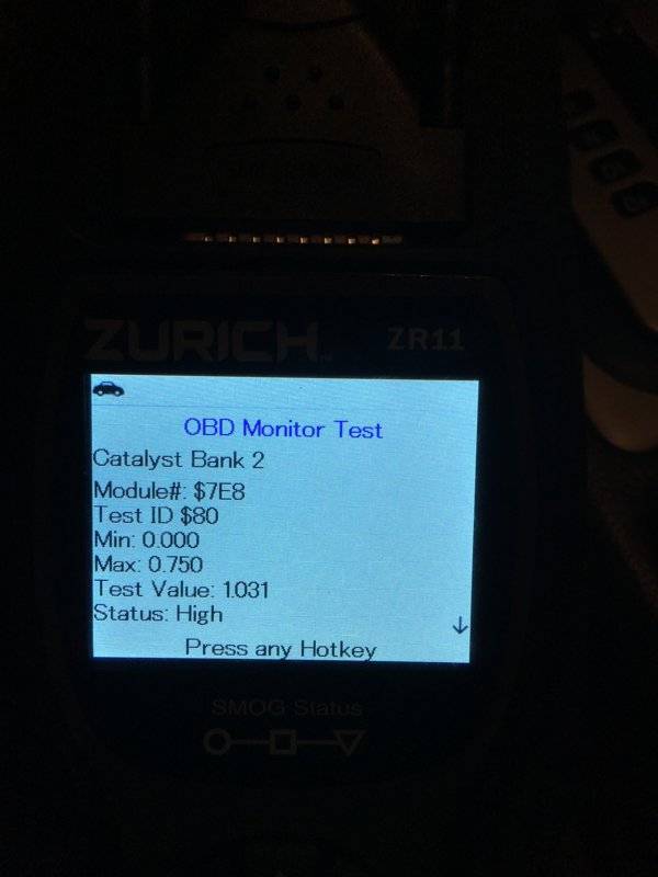

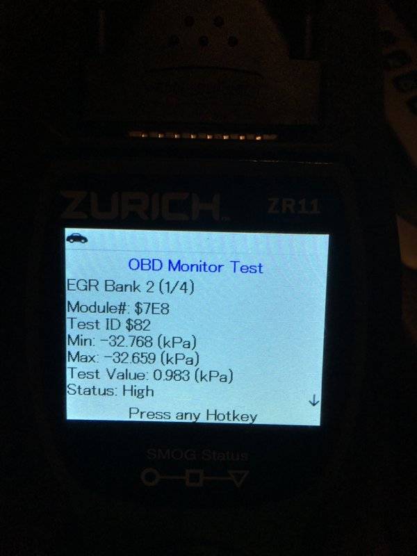

Well I spoke too soon. The same code came back up (0p430) and the egr is what’s coming up as bad on the systems test on my code reader, pics below. I’m thinking I either got a bad egr valve or more likely my ecu is fried. I did drive it with a misfire, bad o2 sensor, and a bad egr valve for 30,000 miles but I’ve fixed all those issues. What are your thoughts? Also I can post pics of any freeze frame or live data you think might help diagnose it.
I am assuming a little dyslexia, then it would be code P0430. This code has nothing at all to do with the EGR.
Do I test that by applying vacuum with a hand pump with the other ends plugged? If so I just did that and they dont hold vacuum.
No... and maybe. If the code is actually p0430... That points to a bad catalytic converter. Probably from driving it for 30,000 miles with a bad misfire... Possibly caused by a improperly functioning EGR. Your o2 sensor might not have been bad after all... But instead telling you the truth.
You could try re plumbing the vacuum lines with regular rubber line and see if that helps. Just make sure you do one line at a time... and follow the color coding.
Either way... It might be too late for the converter.
