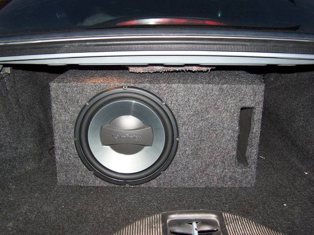

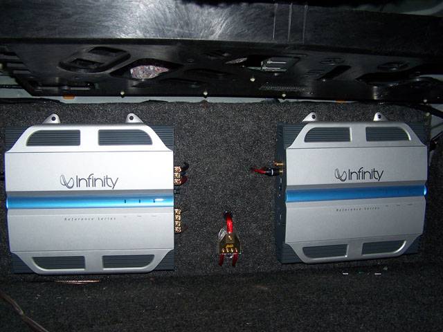

My suggestion, get rid of the stock system. My system is Infinity Reference component 6.5's to replace the factory speakers, and two 2-way Infinity Amps. One amp powers the speakers, and one amp powers the one 10" sub that I have. The system sounds great.:cool:
