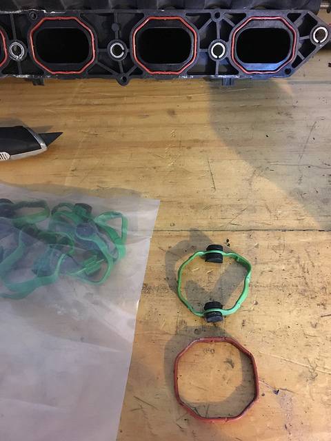

Those gaskets worked, as did the gaskets for both ends of the intake. I just had it repaired at the end of last week. No problems, other than the $662 for the work, which was listed on the bill without any mention of hours. I provided the parts, all bought on ebay.
I'm left scratching my head a bit at this...
The eBay gaskets that you posted had those black rubber tabs on them, but the open manifold picture I've seen have no room for those tabs.
Did your dealer carve the tabs out OR did they just not install them? Those tabs don't like like they simply slide off...
(Credit DeviLSh)
When I took my LS to the dealer for this work, I gave him a set of each of those gasket types. They weren't that expensive and I didn't want them to take it apart and then not have the correct gaskets in-hand. I was told that the mechanic said those blocks were left on and they were installed as-is. I asked out of curiosity, but that word came from the service writer... not from the mechanic.
So, don't know what to tell you...

Hmm, my (big) gut tells me to think twice about trusting that service writer going forward... The lack of hour tracking just adds to that hunch. :(
Anyway, thank you for sharing. I'll tear mine apart and see.
