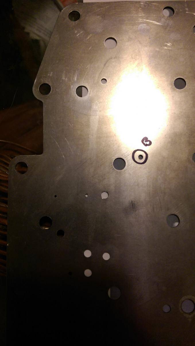

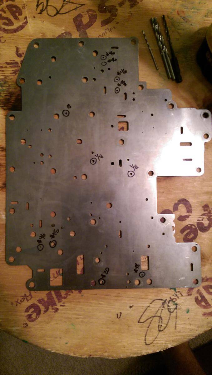

J jbelcourt Dedicated LVC Member Joined Nov 1, 2013 Messages 572 Reaction score 23 Location Orlando Sep 19, 2014 #1 Just need confirmation that this is the correct location of Hole #8 for a 93 separator plate.
J jbelcourt Dedicated LVC Member Joined Nov 1, 2013 Messages 572 Reaction score 23 Location Orlando Sep 19, 2014 #2 Drill bit letter "B" is used for hole #8. Hence why it's marked as B on the plate. Just an FYI.

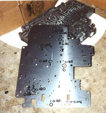

chris2523 93 Mark VIII Joined Nov 8, 2007 Messages 7,913 Reaction score 270 Location Central MO Sep 19, 2014 #3 jamie, look at this pic. you might have to zoom in, but the hole matches your mark. i believe you are good to go.
