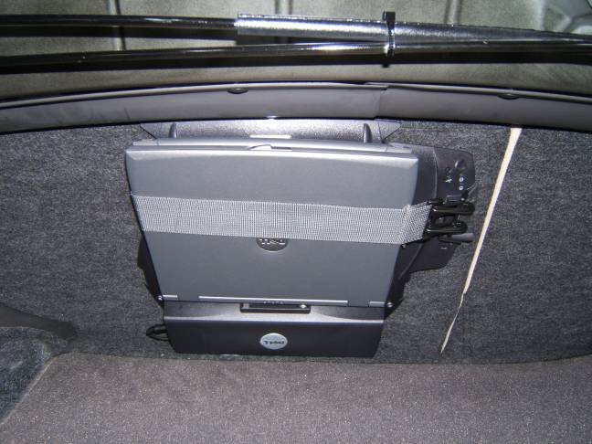

I have my laptop bolted to the back of the backseat - it actually straps into a docking station - so the dock is bolted to the seat and the laptop is snapped into it.
All the cables come under the backseat, side of the tunnel then up under the console.
The keyboard, mouse, usb all come up into the console compartment - so I can plug into them if needed. I rarely use these - sometime plug a memory stick into the usb if I want to play some other music.

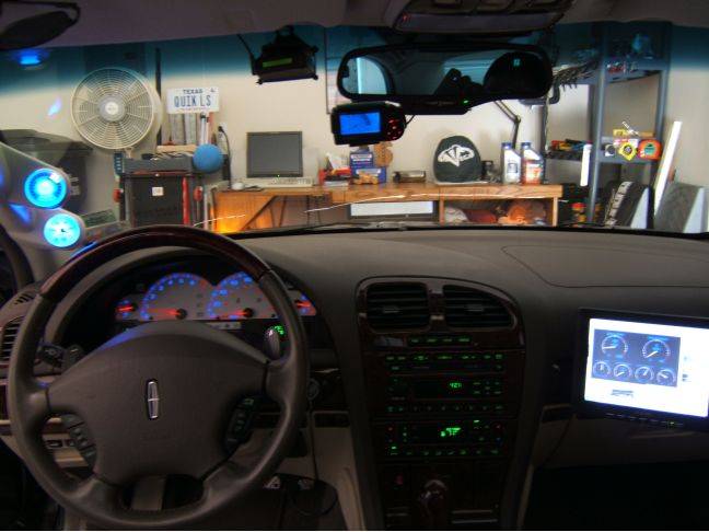

The video cable from the laptop goes to a 8" VGA monitor I mounted up on the passenger side of the cockpit....

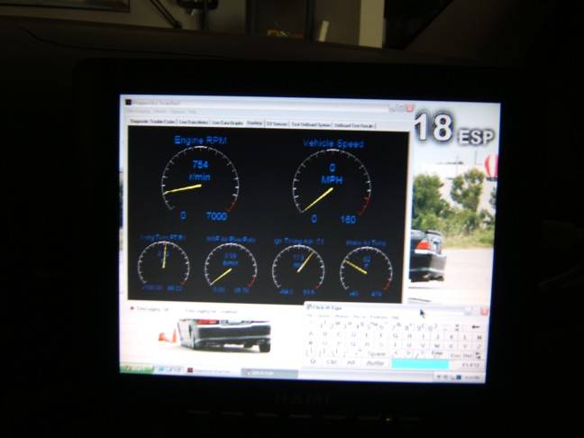

Here's a couple of pics.
the cable is all hidden, the screen is mounted on an arm that is attached to the mounting of the glove box - so no extra holes - and nothing visible if I remove it later.
you can't see the laptop from the truck anymore since the new speaker box went in, but you simple lower the back to get to it.
What are arm are you using to mount the monitor from the glove box?
How can I get one?
Thanks.
I just purchased a tough metal strap from Home Depot - and then bent it to fit the screw hole, come up the edge of the glove box, under the wood trim and the out to the screen mount.
You can only see it if you look up from the floor mat.
So you trimmed the wood grain to mount the screws??? I was thinking about making a mount for my laptop and was looking at that area to see how strong it is (to see if it can hold the weight)
nope - the strap actually fit under and out the top of the wood trim without having to cut anything.
