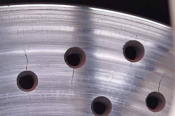

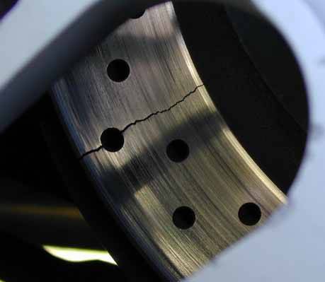

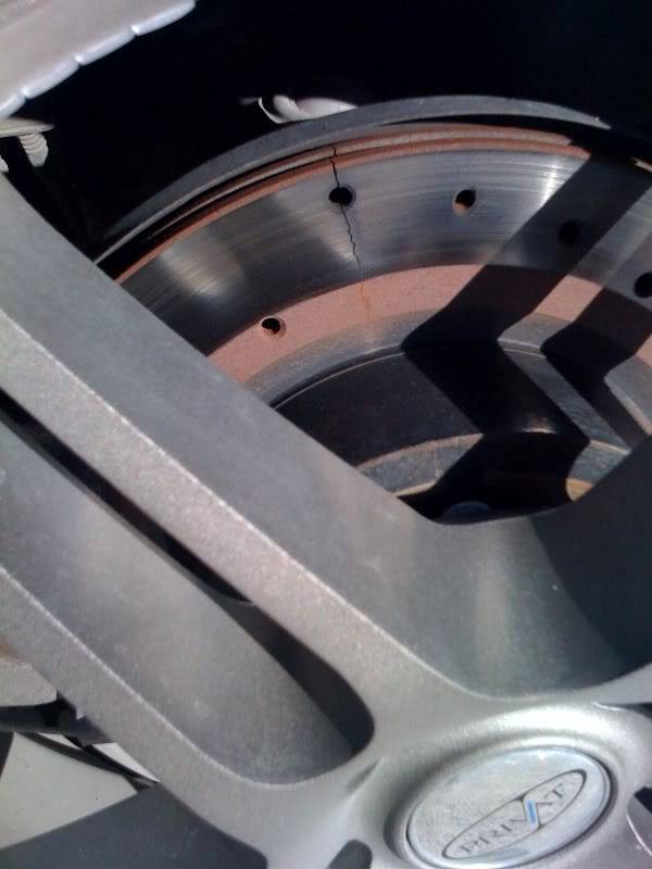

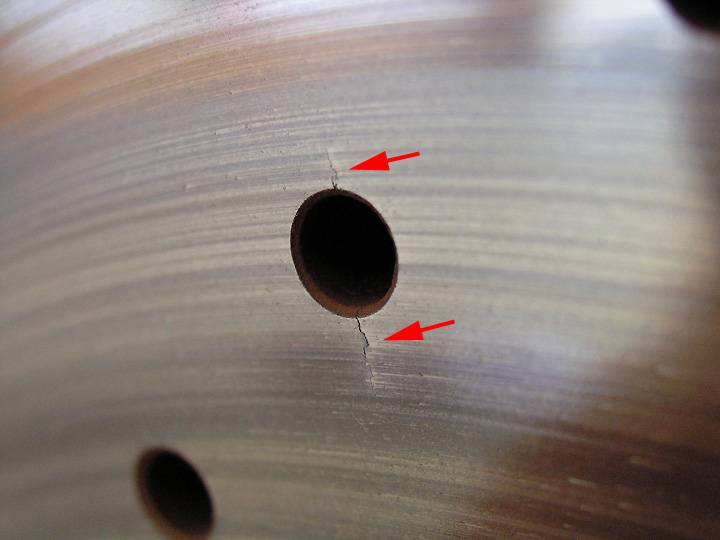

Some examples of drilled from mountain or autocross workloads. Didn't matter if they were chamfered or not:

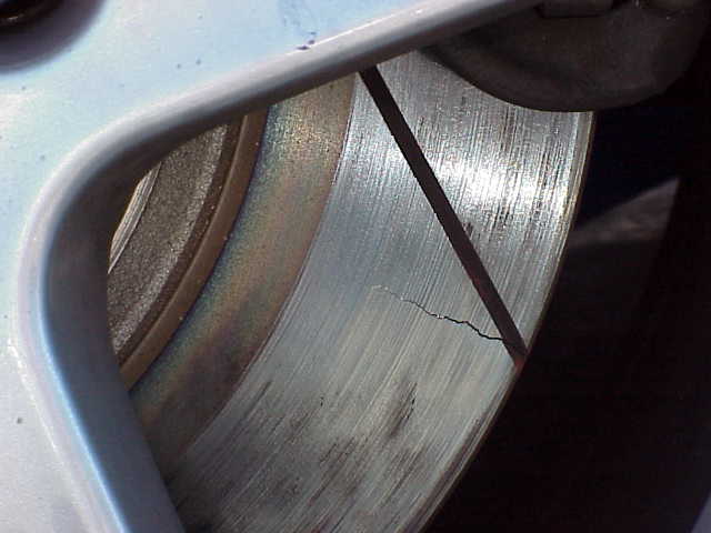

Slotted rotors can develop stress risers too:

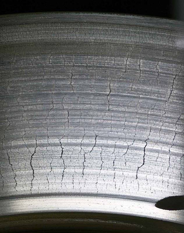

Even non-dressed rotors will have issues with enough thermal strain:
The common denominator in all of these examples if you look closely at the rubbing surface is they have been thermally worked!

them are some pretty scary pictures and why I am now staying away from drilled rotors now... I understand that under any situation any rotor no mater what modification has been done can fail, but drilling them just makes it more pron to happen. Thanks for your input.
Before I scare you away too much, let me say again that even with drilled rotors if the heat is not extensive they may not crack, especially if chamfered. All those examples have bluing and thermal spotting or bands within the rubbing surface. And while cracked, none had a catastrophic failure before the cracking was noticed.
