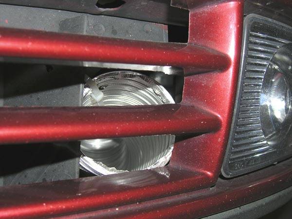

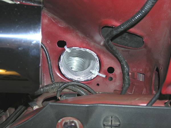

Ok, I used to own a '93 Ford Taurus SHO. It had what has been called the college kid's or poor man's ram air done to it. Basically a dryer vent hose run from the front bumper up to the intake. Anyway, has anybody thought about doing this or is it possible on the LS? Just curious...
Thanks. I wasn't sure. It made a difference on my SHO. Oh well.
You would get colder air, but the "ramming" affect doesn't help much. Besides, it usually screws with the MAF signal due to turbulence anyways which is not good.

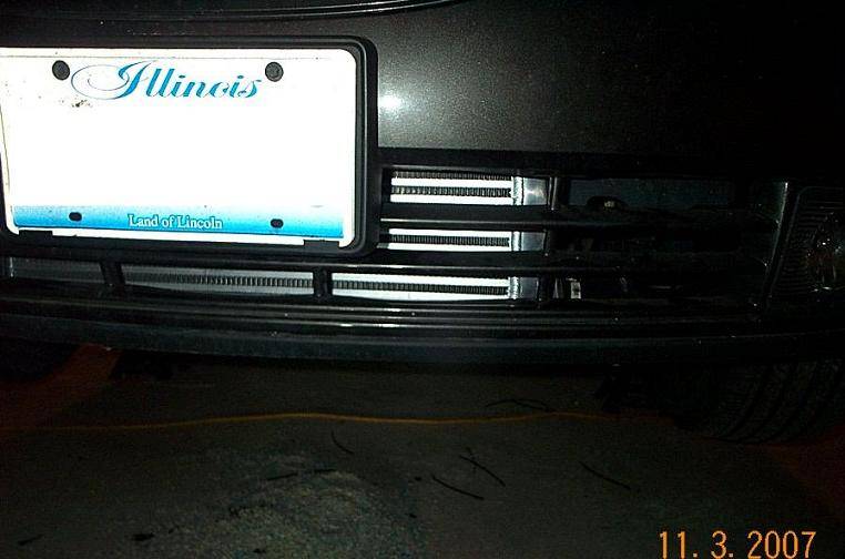

Not to be contradictory to someone with much more LS experience, but Ram Air is used by Ford. If it works on the mustang... Anyway, do you know how well QuikLS's "heat extractor" works? Just curious.
I and others have done that exact procedure for years and haven't had any problems with it. I don't know if it helps, but it doesn't hurt..... and yes, it's for cool air, not ram air.
Just stay out of deep puddles of water.
ILLS is 100% correct:) , it really dont even ram any air in at all just helps to keep cold air inside the engine bay.

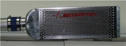

Quik's car is supercharged and thus actually needs a "heat extractor" aka intercooler. The version used on the N/A cars is totally different from real intercoolers even though they look similar. That heat extractor may net a little additional power, but it is not worth it from a money and effort standpoint. Also to be frank, they seem kind of like a poser mod to allot of people. Kind of like putting a sticker of a sunroof on the roof of your car to make people think you have a real one. It is up to you whether to do it though.
The picture on top is a real front mounted intercooler. The one on the bottom is that heat extractor thing. Though they look similar they are totally different.

Ok, to clarify. I was asking about the NACA Air Duct that QUIKLS has put in his hood. I have followed the build up on the supercharger and I know what an intercooler is. I used to drive a highly modified Mustang GT. Also, I was talking about a true ram-air kit with a scoop mounted either under or behind the bumper. Not trying to be a smartass, I'm a car fanatic just LS stupid.Anyway, I appreciate everybodies responses. I'm learning more with every question and answer session.

I was using the dryer vent for an example, as that was what was available to me at the time. I want to make one using proper steel or aluminum pipe (diesel exhaust pipe for reference). Then a sheet metal scoop at the bumper and a custom air box. It may not be ram air but it would definitely be colder and that's always better on these cars. :D
