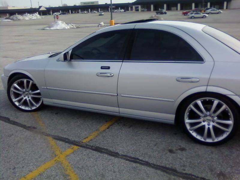

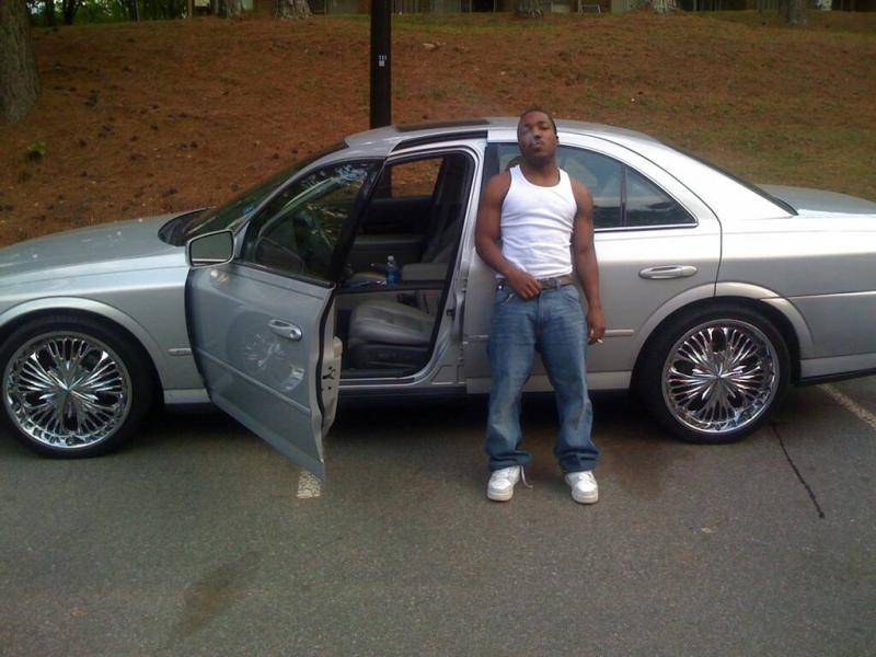

Wait which set? There's no pic in your post. If they're silver those are 20" Sentas, if they're chrome they are 19" Konig Prophets and I have those now. We traded awhile back, by the way the Prophets are for sale.
The 20's rubbed on crappy country roads, but I was lowered on Eibachs and was running a 255/xx/20 tire instead of a 245/35/20. The 19's rode fine lowered and only rubbed on big bumps with the 245/40/19's.
20's lowered
19's lowered
Then the offset or something was off. +42 to +40 seems to be the sweet spot for no rubbing.
+1 size is only recommended for all around driving. Around town more than +1 maybe OK. Freeway/Interstate long trips cause tires to heat/expand blow out. Observed a lot between VA/Montreal, VA/Fla & VA/Mississippi trips. Sidewalls won't make it on +3 sizes sometimes. +2s seem to work most of the times, both put a lot of extra lateral wear on bearings etc. JMHO
