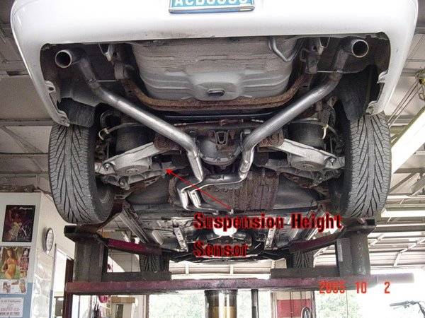

Ok I've searched under my 95 Mark VIII for 2 hours and can't find the sensor for height control. Can someone please tell me where it is and the easiest way to get to it.:mad: :mad:
It is bolted to the drivers side lower control arm on the front portion of the control arm. I have a pic to help you out......:D
