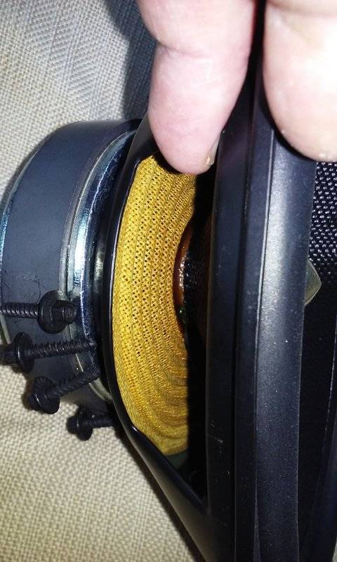

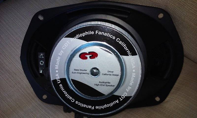

They are open-air 6X8 subwoffers.
I just removed this pair from my Lincoln a couple of months ago. They were replacements, an upgrade. They look good and have beefy magnets, but they just fill in the bass sound, they can't handle much power before they distort.
