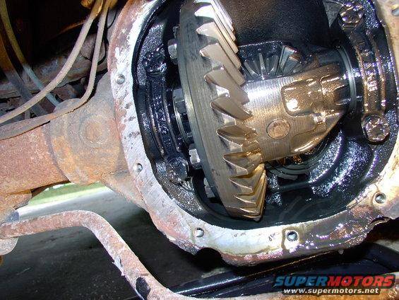

i worked at valvoline for a while and they said that you dont mess with ford rear difs. i know that valvoline is a little screwy but i was wondering if this is true. i have 108k on my 96 town car and was wanting to replace the fluid i just didnt know if it was ok or not. i know never to do the coolant flush on such high mileage cause the last 2 cars i did it to made the engine spray coolant everywhere. that happened to a 91 caprice and my 94 ltc. also transmission fluid. should i just drain and fill my coolant and transmission fluids or leave them alone. sorry for the weak questions but ive never gotten a straight answer because every car is different and i dont want to mess this car up.

At over 100k miles, it's time to replace that rear differential fluid. 80w90 will be good.
