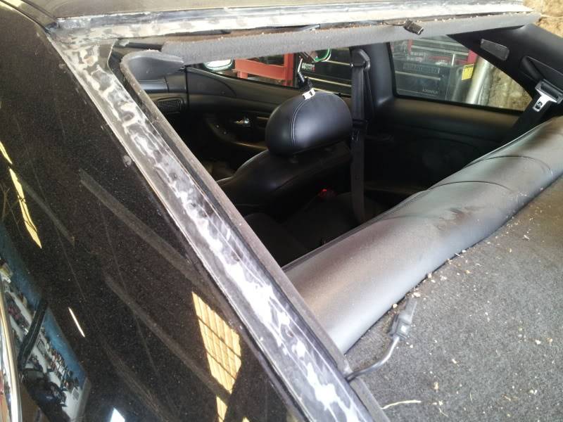

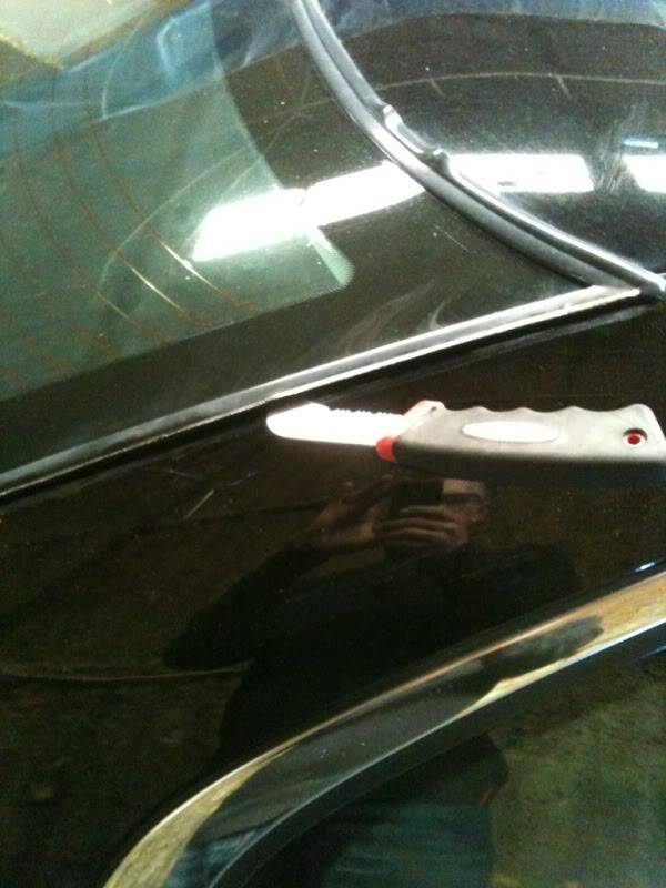

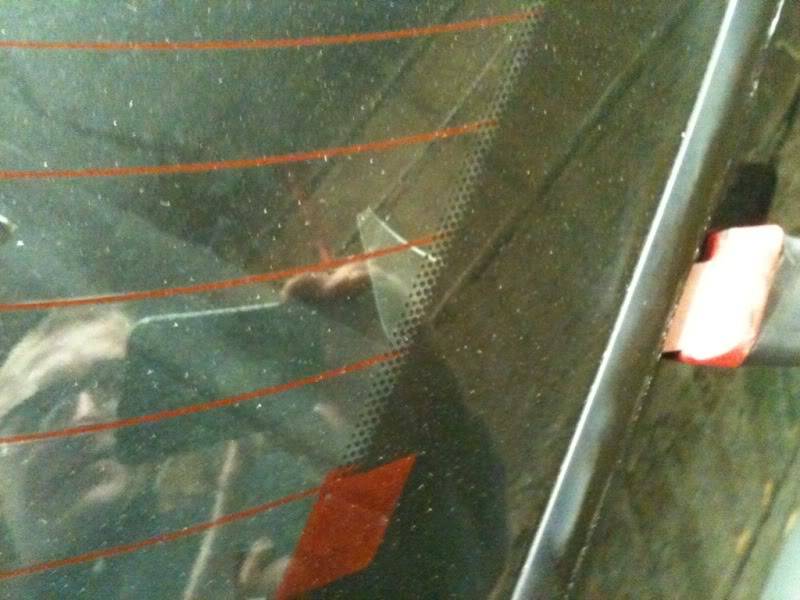

To remove the glass start in the top center from the outside and work your way to the corners, then the center of the sides, I used a long serrated blade to saw thru the corners, then sawed the bottom loose. I would suggest removing the inner 1/4 panels, rear dash mat, and headliner before you begin. Some guys use a battery pack sawsall once they can get the blade in there
Used a da sander to remove the old glue from the car, and a long box cutter blade to clean the glass
How is this done without scratching the sh*t out of the paint near the window seal?
Elfin magic
Or put painters green tape around the edge, the trim lifts up
