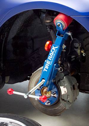

Ok guys. I'm thinking of buying this fender lip roller and using it on my car. If there is interest here on LvC to "rent" it out then I might go for it. Let me know if you are interested in renting it for a short period of time.

To purchase it its 300 bucks. You'd need a heat gun too so the paint doesn't get messed up when your rolling.
Well, I found one for $249 and the heat gun around $40 so total cost with shipping would be around $320 or so. I need to roll the fender lips on my car so it is needed for sure. I may end up buying it this weekend so that I can have something to do next weekend. :runaway:
