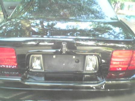

i bought a new surround (used) off ebay for 4 bucks. and went and got it painted for 40. and now i only have the chrome around the windows, and the LS emblems. check ebay, there was a guy who had like 30 of em. heres a pic of mine
the install was simple. all u have to do i take out the carpet(lining) on the top of the trunk. then get a socket wrench and take all the screws out. the there 2 (easy to break) clips, so take ur time. then u pop it out and put ur other one on.
u could just get the one u have painted. i wasnt sure if id like the look so i bought a used one. i love it though, it completes the look, well almost completes.
