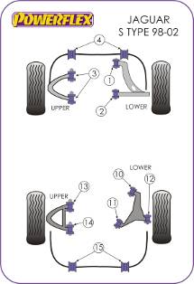

I am currently in communication with Powerflex regarding the numerous Poly bushings they offer for the Jaguar Stype and XF. My lowers are shot, and I am looking into a full refresh of rear bushings for my LS. For what its worth, they list the upper CA bushings as different part#'s than the lowers, and even give different numbers (and images) for each upper bushing itself (#13 vs #14, see below). This may indicate that the lowers/uppers are not compatible.
Lower #12
Upper (front) #13
Upper (rear) #14

EDIT - - - - based on your image above, you'd need 10, 11 (same for inner on the LCA's) and 12 for the outer on the Lower Control Arms. At least those are the ones I would want to replaced as apposed to finding brand new OEM replacement units.

It looks like the only difference in their S-Type lineup is the front-most control bushings, along with position #12. As the LCA up front changed on the later Stype's to the more angled design. (See Kumba's S-Type suspension swap thread. I am excited to hear about the 98-02 version matching to the LS. That gives me hope!

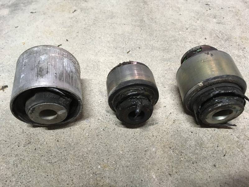

Just to update this thread for anyone who stumbles upon it later - the Rear upper control arm bushing is NOT the same size as the lower.
From left to right, #'s correlate to the diagram I posted above: Rear-Upper Front (13), Rear-Upper Rear (14), Rear-Lower Arm Knuckle side(12).
