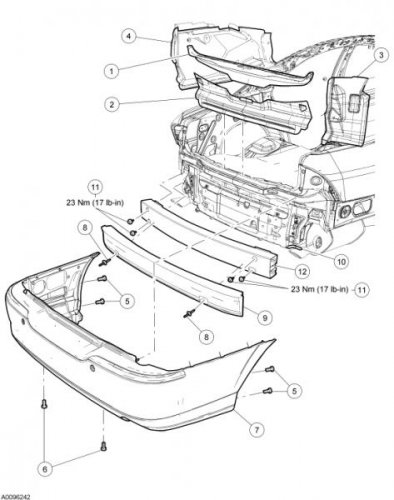

I need to remove the lower rear valance so I can repaint it. I see in the TascaParts.com catalog that it looks like 9 bolts hold it in place. My question is: Can I access all of these bolts/connections without removing the bumper cover?

Nope..... There are a couple of plastic rivets that need to be removed that are only accessible with the bumper removed.

That I don't know for sure.... I know others that have done it and they say it really isn't too bad..... A service cd would come in handy... They are on eBay all the time.

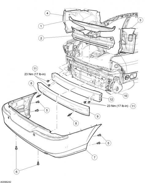

the cds arent that expensive, i would <and did> pay to have a model-specific cd to know for sure on a gen 1 or a gen 2 v6. people here should probably share the files from their cds instead of making ppl pay some random eastern european person $10 for a cd tho...

and fwiw, i removed/replaced a gen2 bumper, and the only reason i couldnt do it by myself from the wheelchair i was in at the time is bc the one rear qtr panel had been smashed 12 inches into the trunk and when i pulled that out the holes for the bumper cover bolts werent in spec anymore. two people and an hour and you should be good to go with remove/replace on an undamaged car
It looks fairly straight forward. Are the nuts metric or standard? I'm headed out to Harbor Freight to fetch a set of deep sockets.

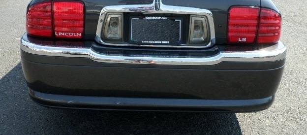

I don't know why I blindly assumed that the rear valance was the protruding lip and that it was removable. It isn't; that is all part of the rear bumper cover. I'm thinking I'll just repaint it while in place and use the line just below the chrome as a masking line.
The valance is the black trim piece on the bottom of the bumper.
F that, I would use the line ABOVE the chrome as the tape line, that way you can get rid of that ugly chrome strip!
