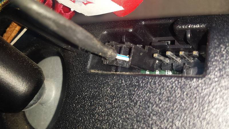

pin order worked, i just took the small connector out of the old mirror, i believe i modified the connector slightly, and plugged it in.
2015-08-13 14.38.49 by Chris Bratten, on Flickr
